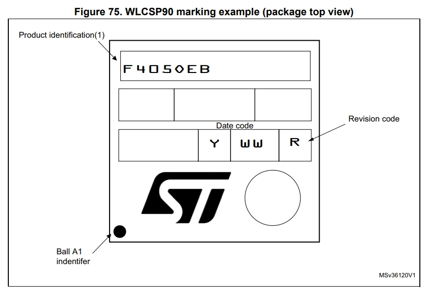

The information needed by the user is provided in the datasheet:
We don't provide detailed explanation. And the two chips are genuine.
Many new chips have 2D QR code marking. for more details you can contact your local FAE/Sales.

Thank you for the response. I have already reviewed the datasheet and understand how to read the date/time information printed on the chips.
However, I have a specific question regarding the markings:
  • AA295 VQ 6 on one chip.
  • VQ249473 AA297 on the other chip.
What do these specific codes represent?
The reason I am asking is that I am using both chips in the same circuit and with identical code, but I am observing a difference in the Ethernet functionality:
  • The chip marked AA297 VQ b works with both newer and older switches.
  • The chip marked VQ249473 AA297 only works with newer switches.
Could you please explain why there is this difference? Are the markings related to internal revisions or production variations that affect Ethernet compatibility?
Thank you for your assistance!

VQ if a diffusion plant in France for the wafer
AA29x is a production/packaging plant in Taiwan
You can determine the chip stepping via the DBGMCU / DEV_ID, and associate that with an Errata
https://www.st.com/resource/en/reference_manual/rm0090-stm32f405415-stm32f407417-stm32f427437-and-stm32f429439-advanced-armbased-32bit-mcus-stmicroelectronics.pdf#page=1716
The production date might shed some light on the options enabled on the F4 dies, ie Ethernet,Crypt, etc
