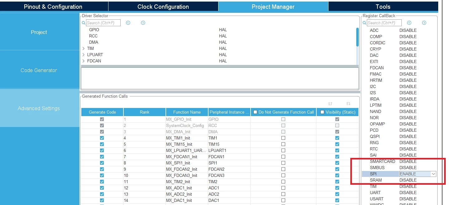

how to handle cube mx overwriting the hal_conf that has to be modified by devs. this looks like a long standing problem (half a decade) an i see no stable solution

As I see it there is a conflict in the instruction "Set below the peripheral configuration to "1U" to add the support of HAL callback registration/deregistration feature for the HAL" and silently overwriting the changes.
As I see it the mentioned workaround of adjusting templates is tedious, complex, error prone.
As I see it the hint to define USE_HAL_xyz_REGISTER_CALLBACKS in Project->Properties dialog is not helping as the problem isn't, that it isn't defined, but it is defined with the wrong value.

    AVasi.11
    Apr 28, 2023 7:59 PM UTC
    Writing software on the STM is like solving quests all the time. Unfortunately, in my experience there are more than TI or Microchip, for example. Lots of bugs even in rm that haven't been fixed for years
    I managed to solve this quest in 3 minutes, I guessed that there should be settings in the cube

    AScha.3
    Apr 29, 2023 8:37 AM UTC
    as shown by AVasi , you can set REGISTER_CALLBACKS in Cube ;
    you have to update Cube/IDE to newer version (IDE 1.10 or newer), to get this callback settings.
    look, maybe you have it and just didnt know... or update.
    _richard
    _richardAuthor
    Apr 29, 2023 9:20 AM UTC
    yes, you are right, the cubmx configuration is now possible, even as it is not obvious where to find it.
    the suggested #ifndef approach would allow switching configuration easily in code / during build -> cubemx as basline, further configuration e.g. by build profile (defines).
