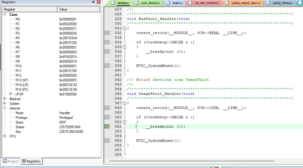

How to get the faulty location on a UsageFault on F429?
Hi all,
in my firmware I fall in a UsageFault but, since I have some tasks, I not able to understand which instruction caused the fault. Both PC and LR are pointing to the handler ..
I attached the current screen.
Thanks!
STOne-32

Dear @SteMMo ,
You can refer to this Knowledge Article :
https://community.st.com/t5/stm32-mcus/how-to-debug-a-hardfault-on-an-arm-cortex-m-stm32/ta-p/672235
Hope it helps ,
STOne-32
