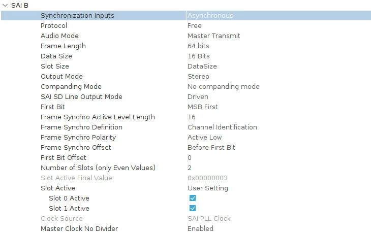

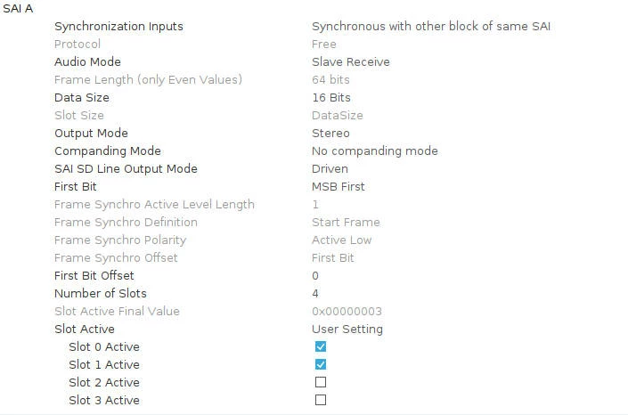

What I want to do is get an audio wave from line_in (the blue audio jack on the board).
The setup for SAI1 is in the picture, I can play the audio through the line out without any problem but can not get the readable waveform data from the line in.

if (HAL_SAI_Receive_DMA(&hsai_BlockA1, (uint8_t*)recordBuff, RECORD_BUFFER_SIZE) != HAL_OK) {
 Error_Handler();

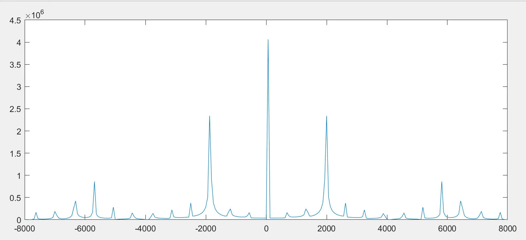

The audio input is a 2k sin waveform, what I got from SAI1 are:
0693W00000Kde2ZQAR.jpg0693W00000Kde2VQAR.jpgIt does have the 2k frequency peak, but the waveform is far from a sin wave, what could be the problem?

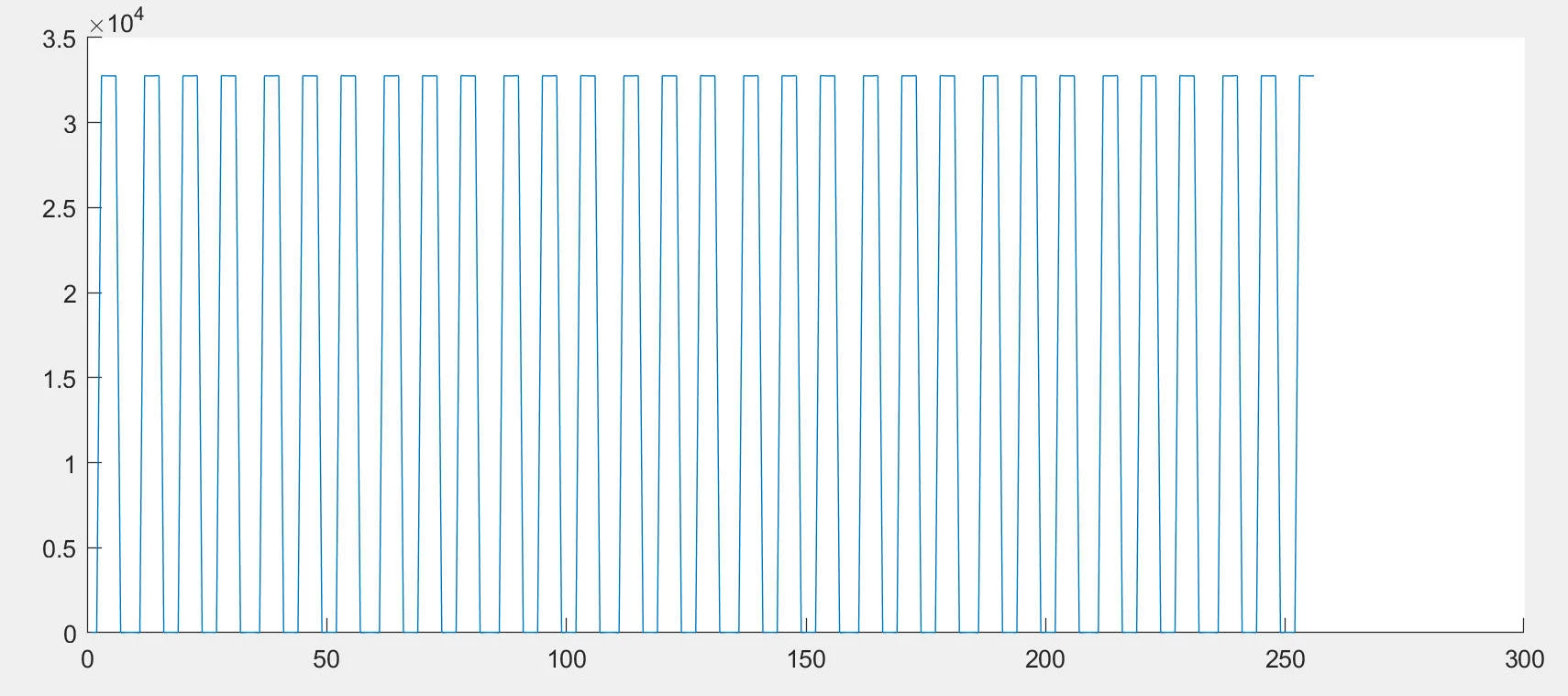

It seems something happened with the first bit of some data. The received values are something like ...,32761,32765,3,8,13,... which should be ...,-7 (32761-32768), -3 (32765 - 32768), 3, 8, 13,...
Even if I modify the value manually, the value seems to be too small, the amplitude is less than 30.

Hi MMuba.1, thanks a lot for your nice tutorial, but I still have the problem that the received value is too small. If I disable the 30 dB gain, the maximum received value would be 30, if I enable the 30 dB gain, the maximum received value is 70.
I expected the value range should be [-32768, 32767], what could be the problem?
