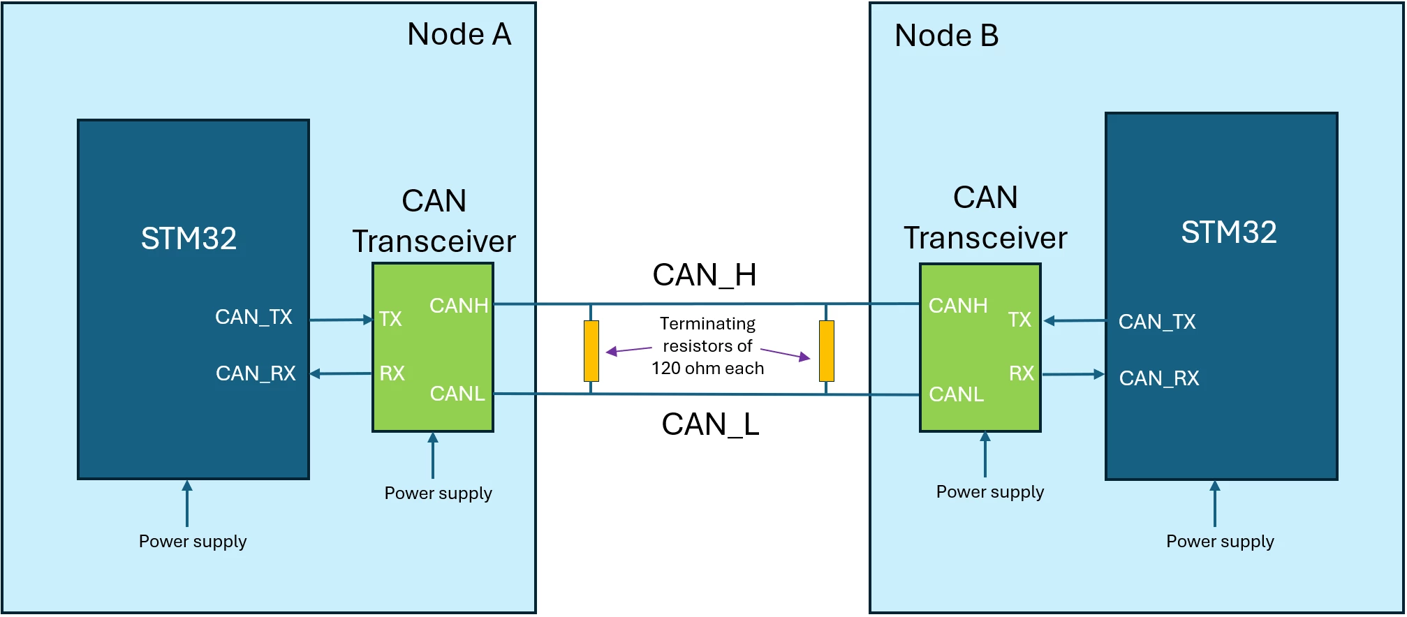

You cannot do that in Normal mode.
hfdcan1.Init.Mode = FDCAN_MODE_NORMAL;
This is the minimum hardware required to establish a CAN bus:
You need at least another node on the bus for the acknowledgement mechanism. CAN is not UART or SPI to use it in stand alone.
Use External loopback mode instead, where you can use one node in stand alone and monitor the Tx pin.
Hope that helps.

STM32G0B1CBT6 is a MCU not an board. So what board are you using? ST board? custom board? please show image of the board or a link to an image of it. What do you mean by "is not working?"
Are you establishing a complete CAN bus with two nodes and each one having a CAN transceiver?

Currently, no other CAN nodes are connected. I'm monitoring the pin states with a logic analyzer.
