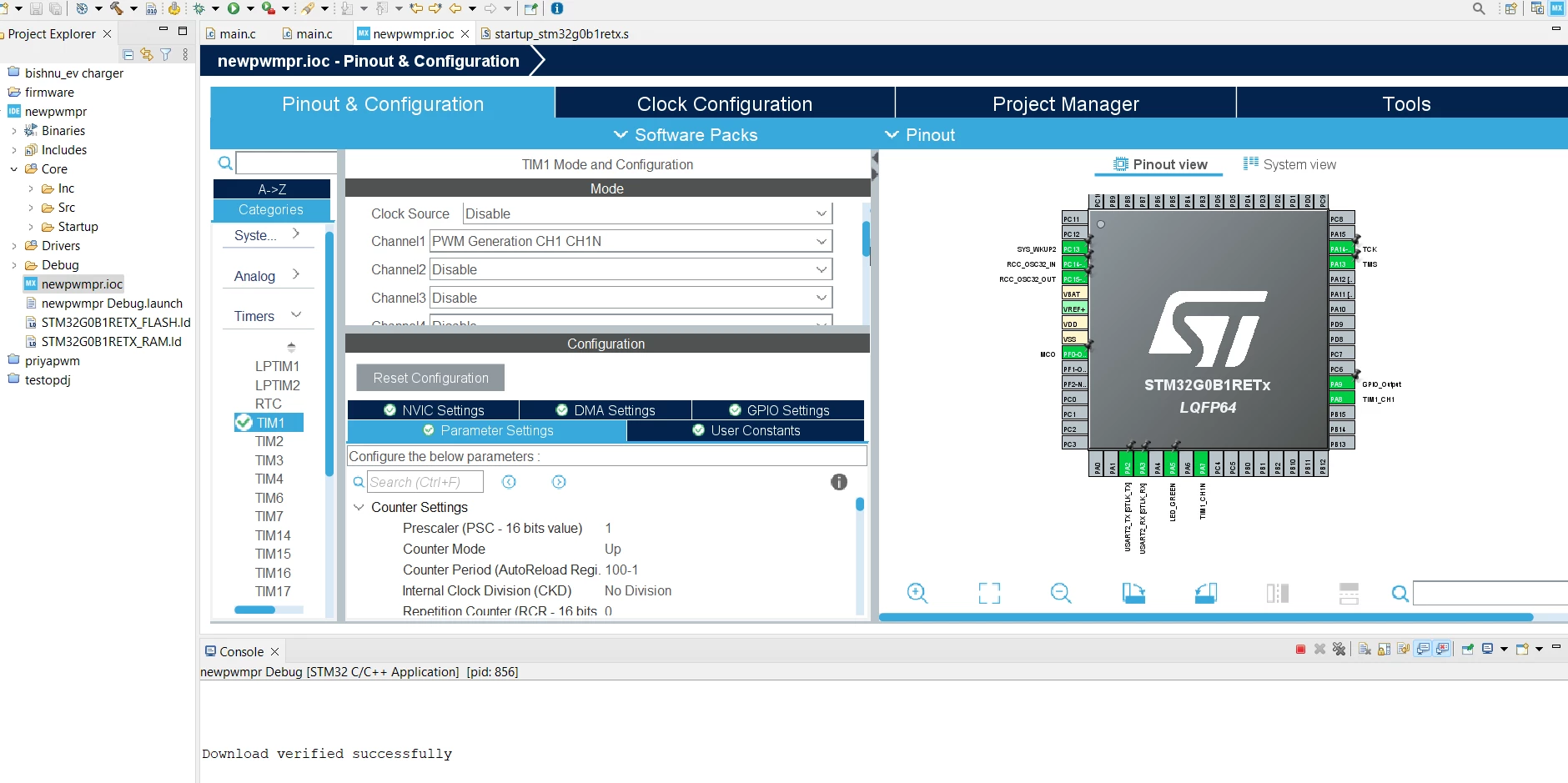

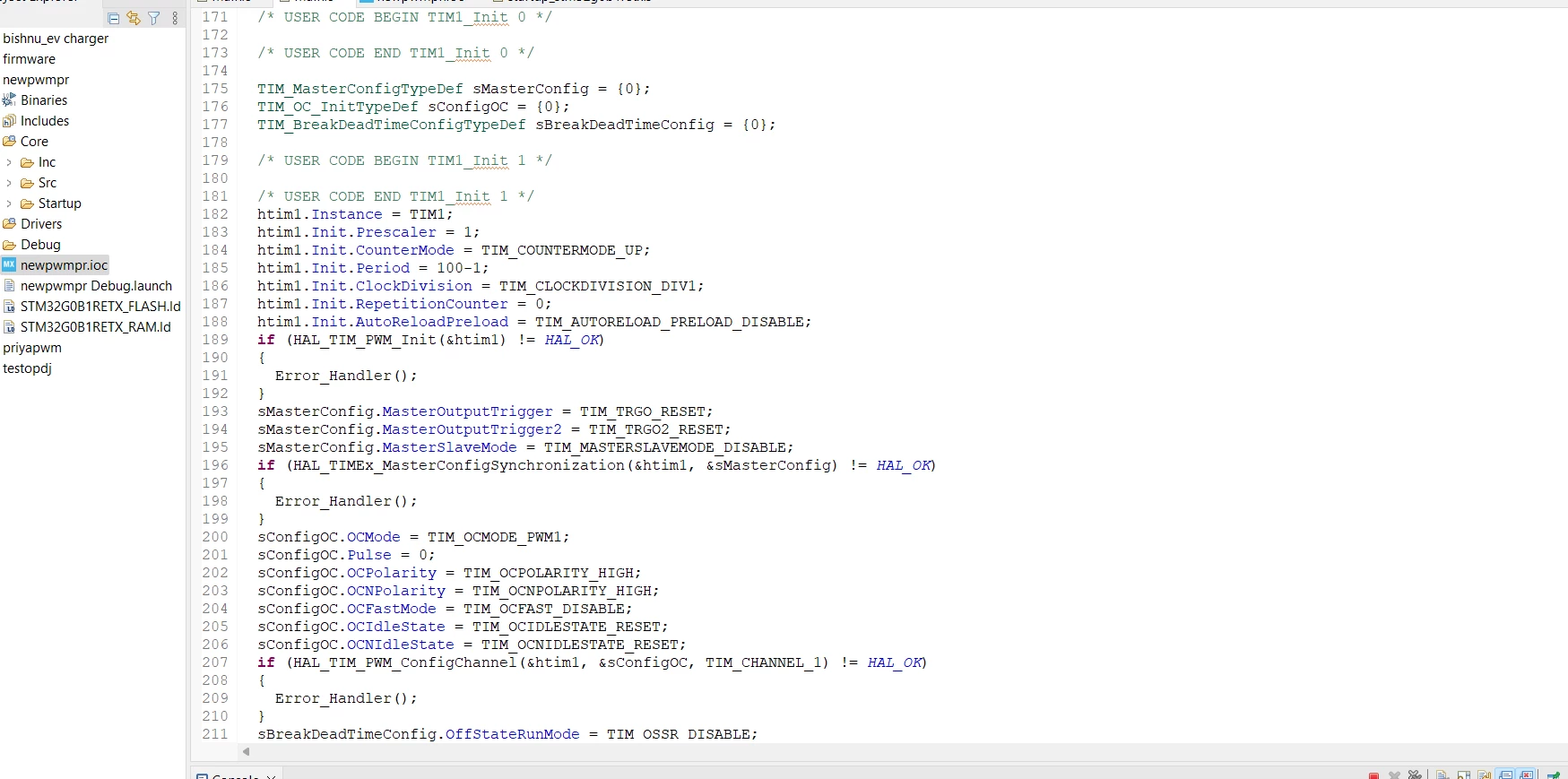

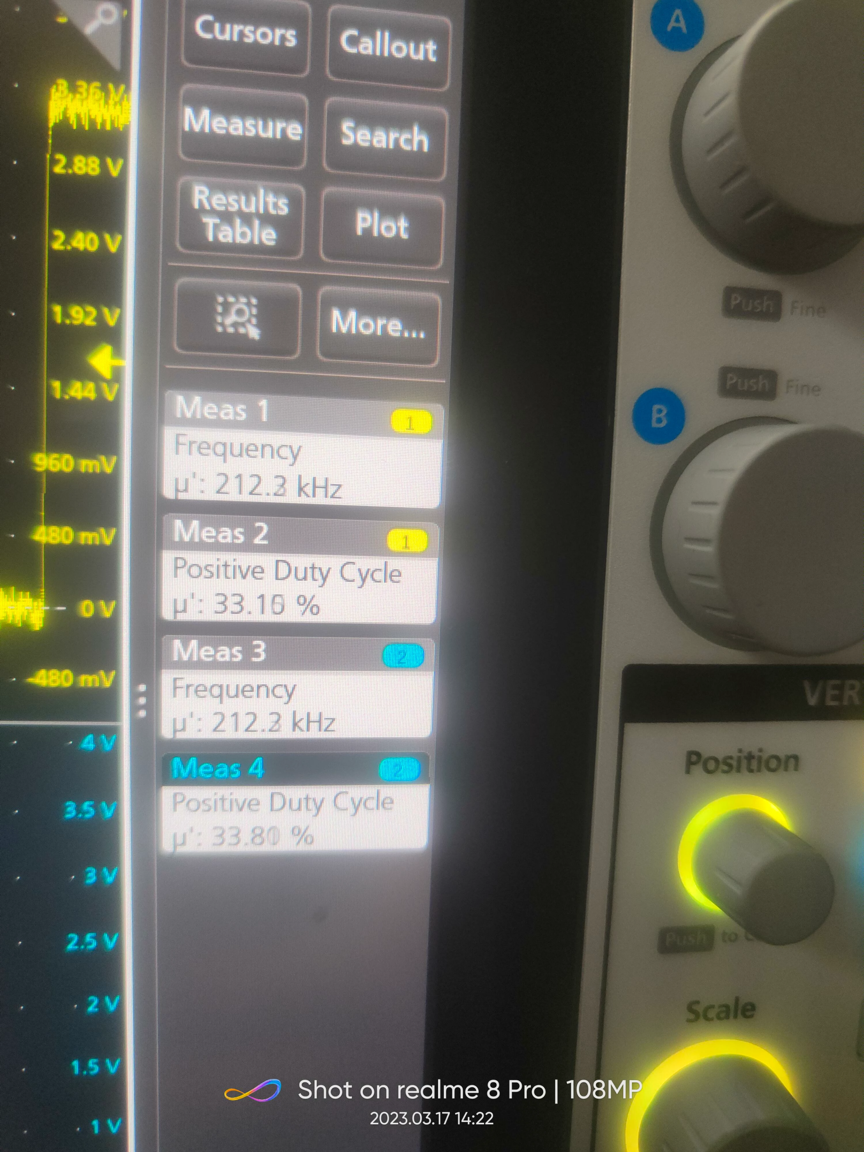

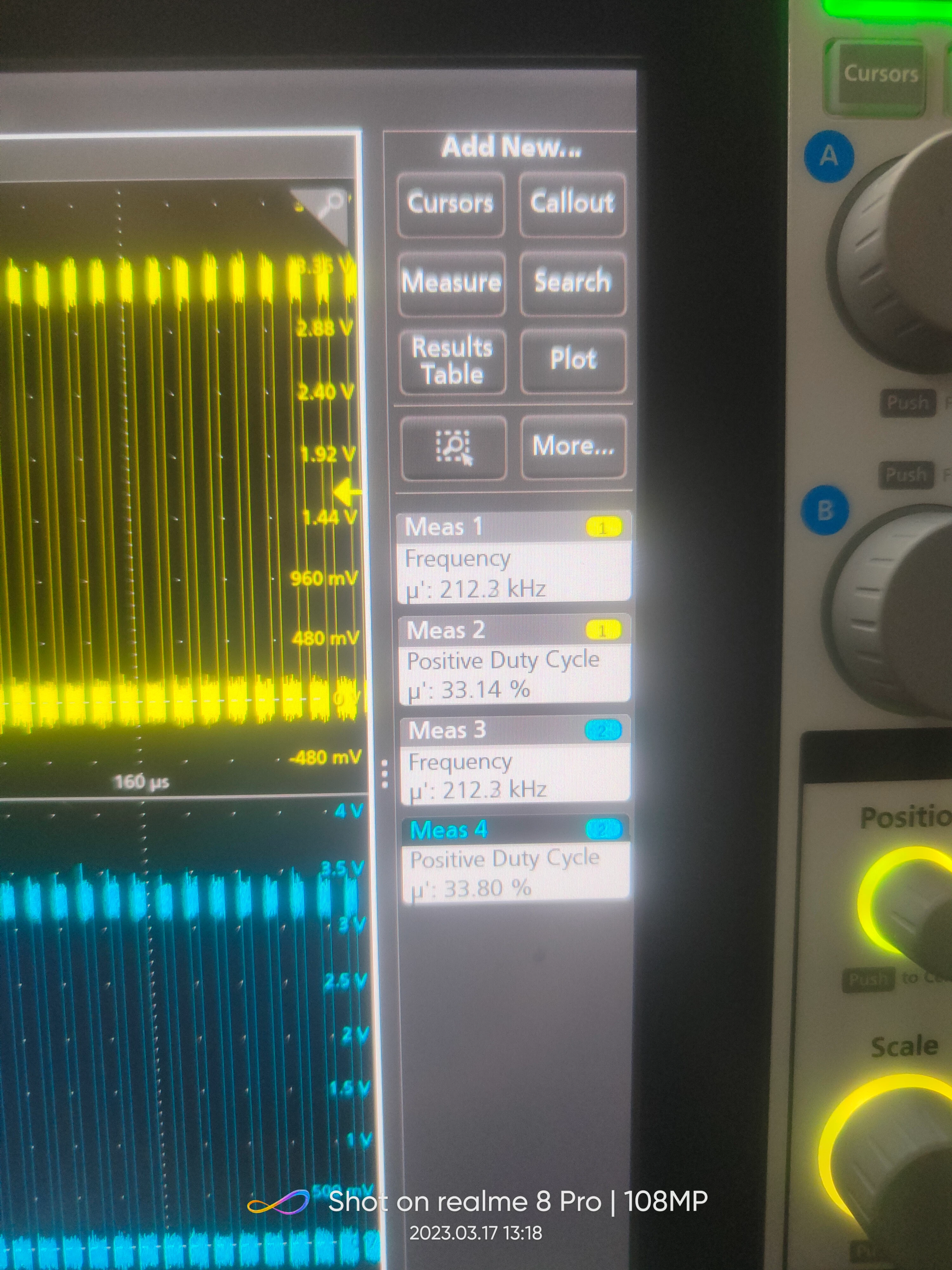

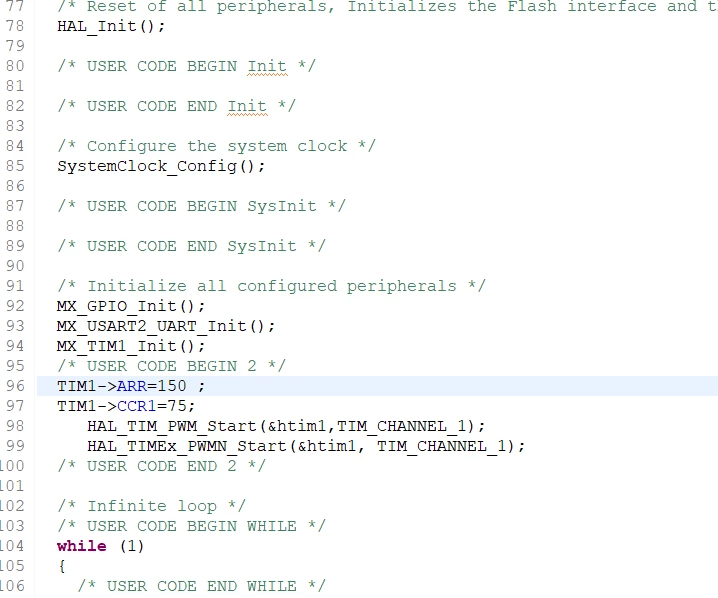

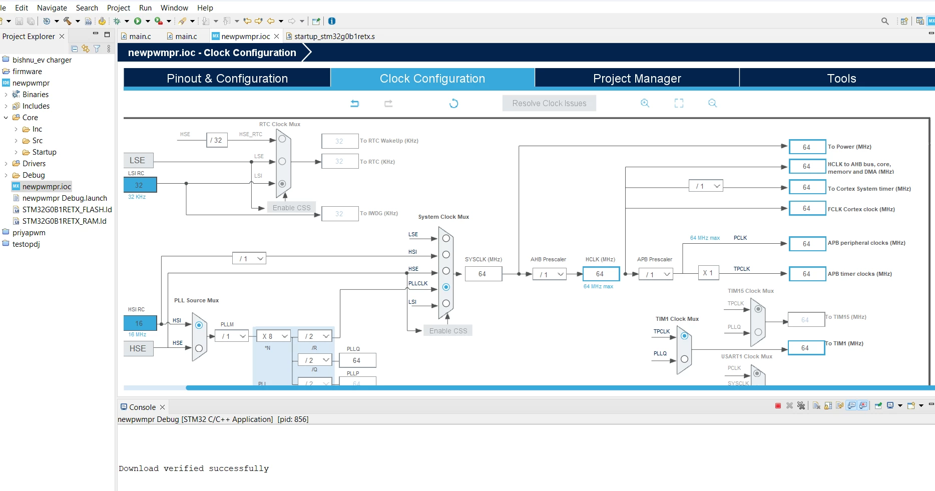

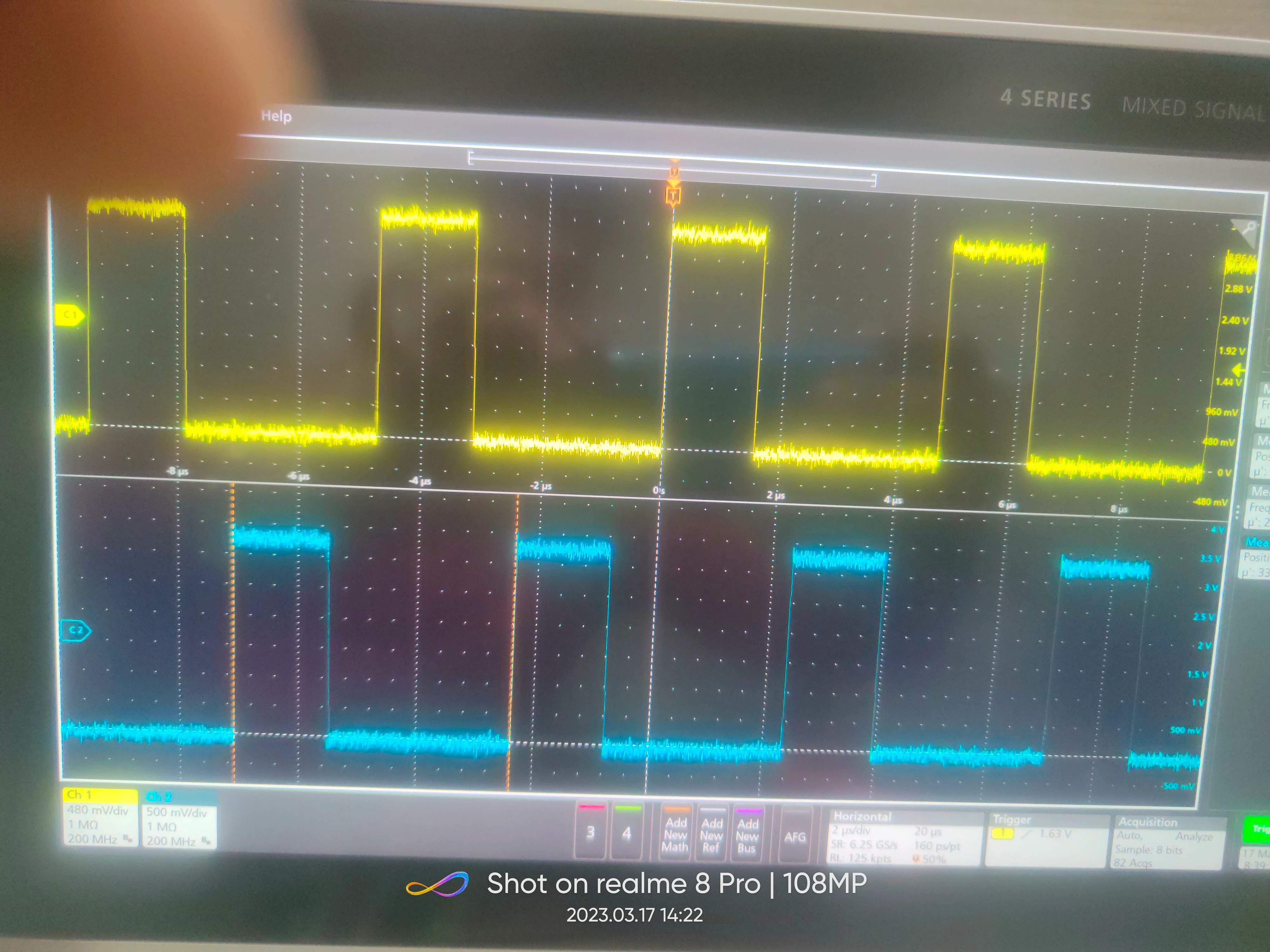

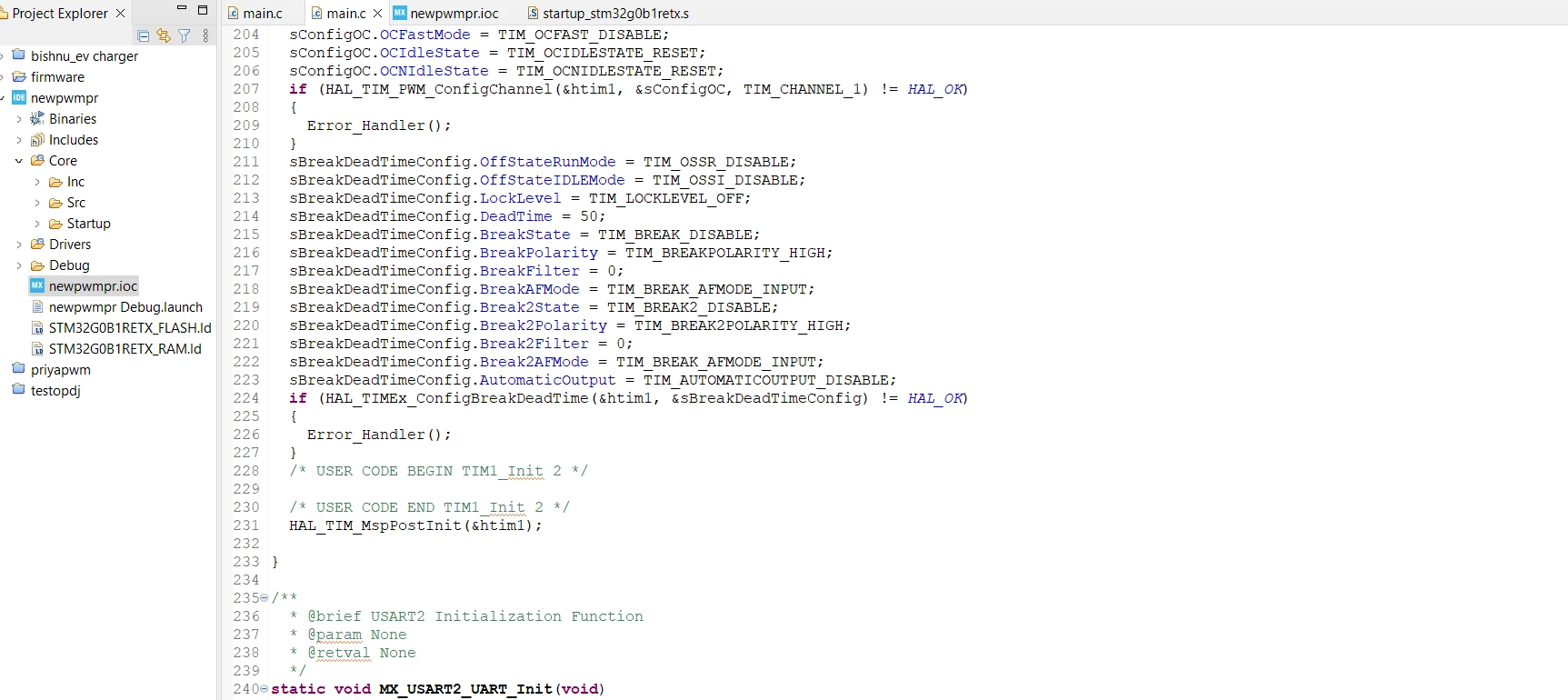

how to get 50 % duty cycle with complementry pulse
i want to generate 50 % duty cycle at freuency (100khz-200 KHz), but i am not getting 50% , i am getting 33-34% duty cycle.this duty cycle change when the frequency change.
