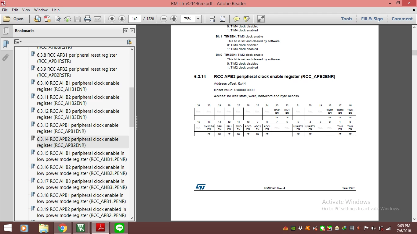

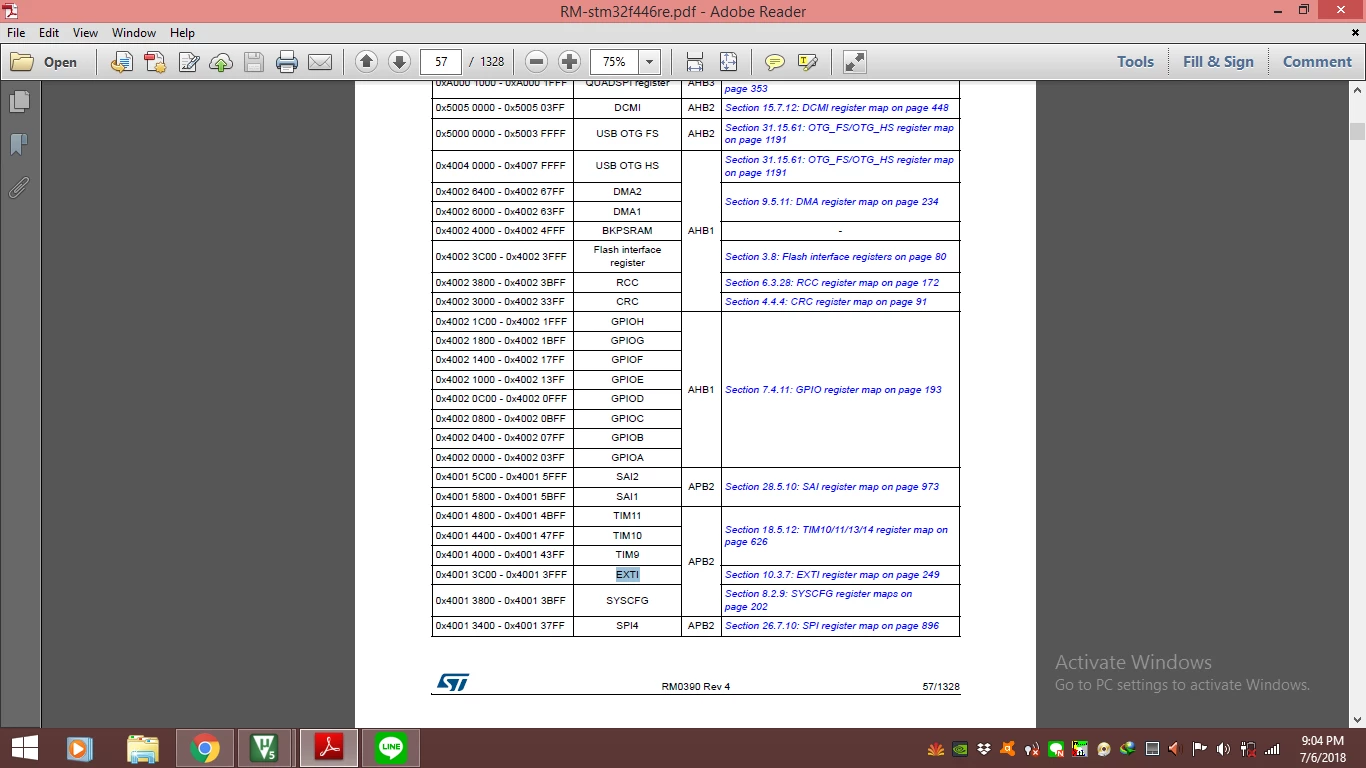

Sorry for my stupid question, but this makes me really confused. I was just looking for the the bus with connected with the EXTI, then I found that APB2 bus is connected as it is shown in the reference manual in here :
https://www.st.com/content/ccc/resource/technical/document/reference_manual/4d/ed/bc/89/b5/70/40/dc/DM00135183.pdf/files/DM00135183.pdf/jcr:content/translations/en.DM00135183.pdf
But when I tried to activate the clock for APB2 bus in APB2ENR, I cannot find in what bit is the EXTI in.
Then I got confused in what bus and what bit is it to activate the clock for exti. Sorry for this stupid question, by the way I am a new learner

EXTI clock is always enabled.

Anthony Lauly
July 7, 2018
Posted on July 07, 2018 at 05:50
So I dont have to enable it with APB2ENR ?
waclawek.jan
July 8, 2018
Posted on July 08, 2018 at 00:56
No.
