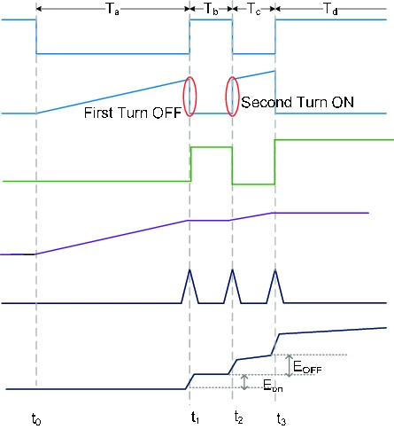

Is there a way to generate multiple pulses of different lengths with a timer?
This is needed to perform a double pulse test, by controlling the B6-Bridge Driver of a B6-Bridge.
The first pulse is longer than the second pulse (e.g 300 us). The second pulse is shorter (20 us) and comes after a short pause after the first pulse stopped (10 us).
LOW -> First pulse (HIGH for 300 us) -> pause (LOW 10 us) -> second pulse (HIGH for 20 us) -> LOW
As the time periods of these pulses can get pretty short, I was adviced to realise this task with the PWM-generation via timer on the STM32F407 Discovery Board (up to 168MHz).
In the end I need to have six outputs for these PWMs Two of them are used for the pulses, while the rest is always LOW. According to which phase of the motor is currently tested, I'll need to change which of the six outputs is pulsed and which are not. One of the two pulsed outputs is like I already stated above, the othere output is to be the inverted version of the pulses with a deadtime.
Pulse lenghts and deadtime should be configurable by the user.
I'd be very pleased if someone could help me on this topic.
