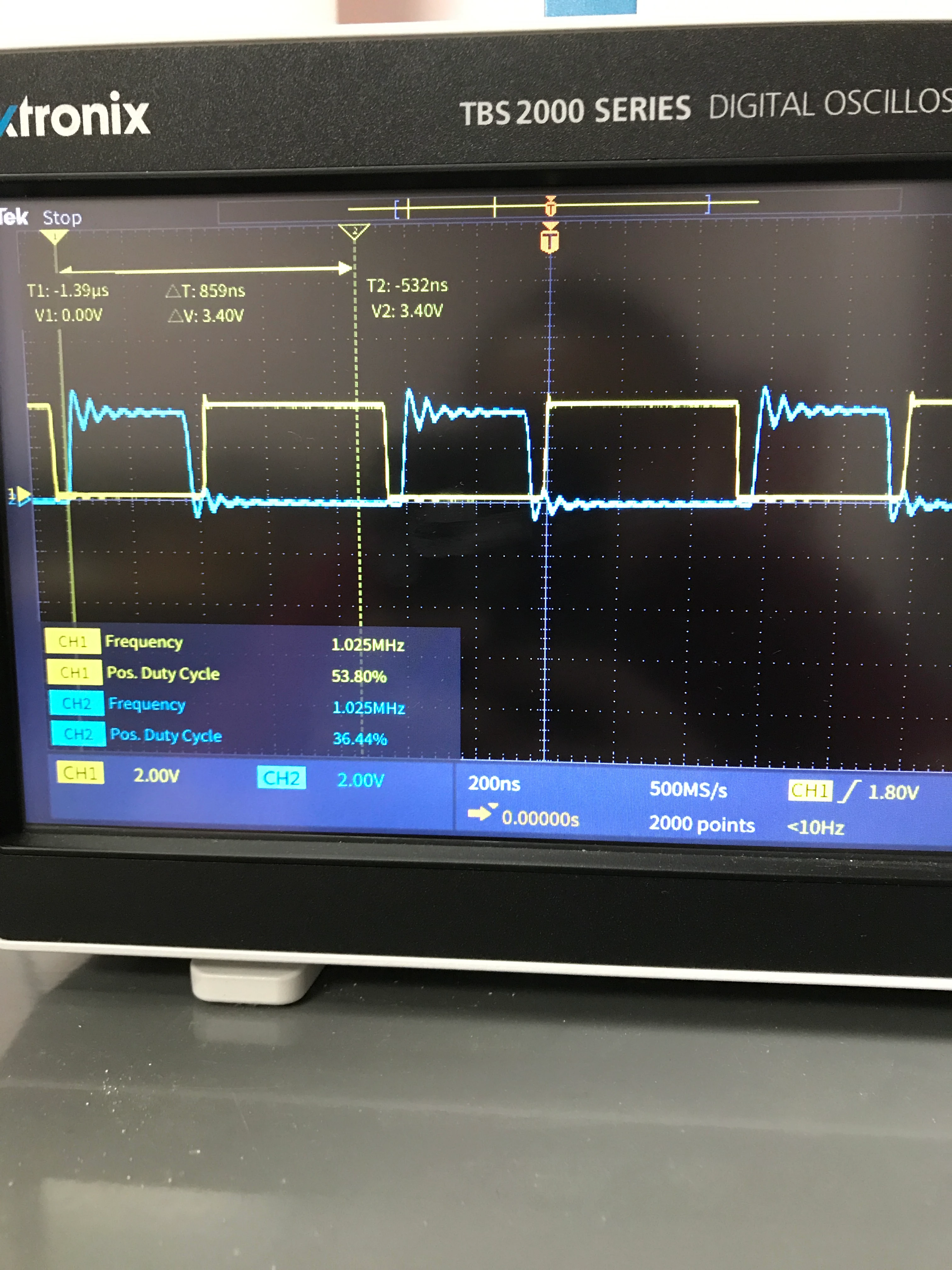

I need to be able to generate a center aligned PWM signal on two Ch. with 1.5MHz PWM frequency. The duty cycle variation will have dead time inserted in it. In order to generate 1.5MHz for center aligned signals, I need to calculate ARR Register for 3 MHz PWM frequency.
I am currently exploring this with Nucleo-F446RE bare metal programming. I selected PLL of 84MHz Timer Clock Frequency. But still, I am not able to get good precision / resolution in the PWM duty cycle and the signals looks skewed as well due to such high PWM frequency.
Is there any other chip family more suitable for such application? What's the best method to be able to generate such PWM signal and get good control over duty cycle variation?
