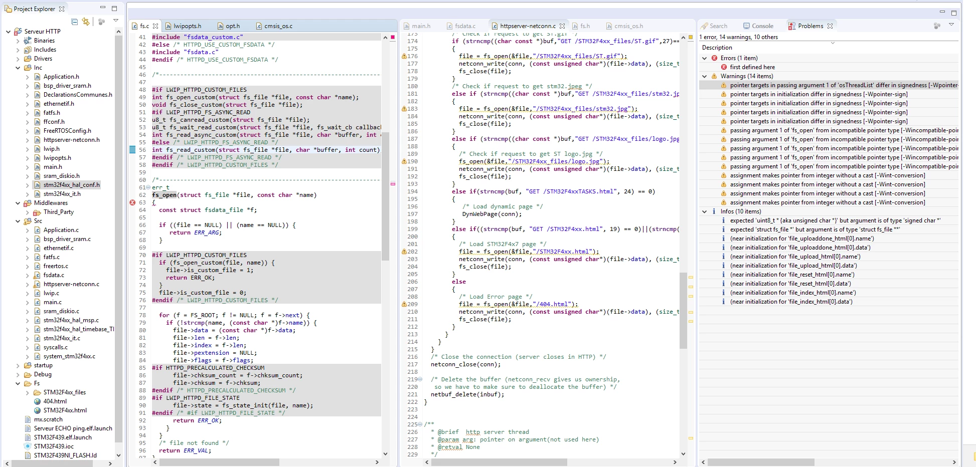

    KI am using LWIP , STM32F4 and I want to iimplement an http web based on netconn API in the board.
    I activated httpd from CubMX, I downloaded makefsdata.exe from internet and I generated with it the fsdata.c file..
    In the fs.c generated by CubMX there is error in the fnction fs_open
    in the programm of the http I am using I wrote this
    file = fs_open(''/STM32F4xx_files/stm32.jpg'');
    In fs.c file
    err_t
    fs_open(struct fs_file *file, const char *name)
    const struct fsdata_file *f;
    if ((file == NULL) || (name == NULL)) {
    return ERR_ARG;
    I did not understand the error exactly
    You will find attached the capture of the error and the programm

    If you read the LwIP documentation, you will find that you have to write your own custom fs_open to do what you want to do

    Pavel A.
    May 28, 2018
    Posted on May 28, 2018 at 13:37
    else if((strncmp(buf, 'GET /STM32F4xx.html', 19) == 0)||(strncmp(buf, 'GET / ', 6) == 0))
    /* Load STM32F4x7 page */
    file = fs_open('/STM32F4xx.html');
    netconn_write(conn, (const unsigned char*)(file->data), (size_t)file->len, NETCONN_NOCOPY);
    fs_close(file);
    else
    /* Load Error page */
    file = fs_open(&file,'/404.html');
    fs_close(file);
    Indeed in this htppd.c usage of fs_open is inconsistent.
    If this code comes from some 'static'  template, need to fix it.
    Or, get updated sources from the home site of LwIP project.
    -- pa
    Jessy J
    Jessy JAuthor
    May 28, 2018
    Posted on May 28, 2018 at 13:59
    Yes I corrected it like this
    struct netbuf *inbuf;
    err_t recv_err;
    char* buf;
    u16_t buflen;
    struct fs_file * file;
    /* Check if request to get ST.gif */
    if (strncmp((char const *)buf,'GET /STM32F4xx_files/ST.gif',27)==0)
    recv_err = fs_open(file,'/STM32F4xx_files/ST.gif');
    fs_close(file);
     But i get a warning sayin ' file may be used unitialized in this function .wht does this mean ?? it is declared u nthe begining of the function
    Thank you for help
    Pavel A.
    May 28, 2018
    Posted on May 28, 2018 at 14:23
    Try this:
    struct fs_file file;
    recv_err = fs_open(&file,'/STM32F4xx_files/ST.gif');
    -- pa
