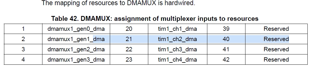

In STM example TIM_DMA, I see it uses PA10 - TIM1_CH3 with DMA channel 5, but I could not find anything about this. Anyone know how to find this information? I would like to use different pins but don't know what DMA channel mapped to them.
All I found is, in user manual, tim1_ch3_dma stick with 22, not sure what it means.

The STM32C0 doesn't have DMA channels the way than the STM32F7 does. Instead, the mapping is done through the DMAMUX. In this case, input 22 is TIM1 channel 3.

Can you a bit more specific?
Here is a piece of my code and I already get it working on PA1 which is TIM1_CH2
I understand input 22 is TIM1 channel 3, 21 is TIM1_CH2, but my code, I don't need to know this number. All I need to know is channel to set to Instance, enable interrupt, example:
hdma_tim1_ch3.Instance = DMA1_Channel5;
I don't see how to use input "22" anywhere in ST example, how to use input "22"? what is relationship "input22" to DMA1_Channel5?

That's arbitrary - up to you. Any channel may be used for any peripheral.
