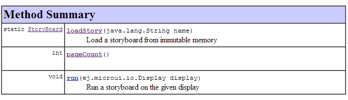

I buy the STM32F40G-JAVA eval board,i got a problem when i used the MricoEJ to develop the project.
I read the STM32Java-UI-PACK user's Manual,In the 7.2.4 it shows that how to edit stroyboard, i did it follow the document said ,however, i don't know how to execute it and display it in the simJPF you know, i write it like this,,i read the class summary about stroyBoard ,it show that it have the method ,then i write the code ,In a pity ,it has error,can't find the source,i don't know why.
public class MyTest {
* @param args
public static void main(String[] args)
// TODO Auto-generated method stub
Display display;
display=Display.getDefaultDisplay();
StoryBoard.loadStory(''Mystoryboard'').run(display);
THIS IS ERROR:
Exception in thread ''main'' java.util.NoSuchElementException: Mystoryboard is not a valid Immutable ID
at java.lang.Throwable.fillInStackTrace(Throwable.java:130)
at java.lang.Throwable.<init>(Throwable.java:59)
at java.lang.Exception.<init>(Exception.java:20)
at java.lang.RuntimeException.<init>(RuntimeException.java:25)
at java.util.NoSuchElementException.<init>(NoSuchElementException.java:22)
at ej.bon.ImmutablesFile.get(ImmutablesFile.java:45)
at ej.bon.Immutables.get(Immutables.java:94)
at com.is2t.storyboard.StoryBoard.loadStory(<unknown source file>:22)
at MyTest.main(MyTest.java:16)
do you have some demo or reference manual can i have a look ,thanks .

    Hi Roy,
    Some ideas:
    * Don't forget to Enable storyboard support in your project: launcher
     In menu Run configurations
          JPF Configuration
              Storyboard
                    Enable story board spport and add you storyboard file .
    * Other ideas:
    Try the story board example proposed in File Java example. The code is somethning like that:
    import
    com.is2t.storyboard.StoryBoard;
    import
    ej.microui.io.Display;
    public
    class
    StoryboardAppnotesLauncher {
    public
    static
    void
    main(String[] args) {
    // 1. load
    storyboard
    from
    Immutables
    StoryBoard myboard = StoryBoard.loadStory(
    ''Example''
    Display[] displays = Display.getAllDisplays();
    // 2. run it on last available display
    myboard.run(displays[displays.
    length
    - 1]);
    } Best regards
    Phil

    hello phil:
    thanks so much.
    i figure out the problems.
