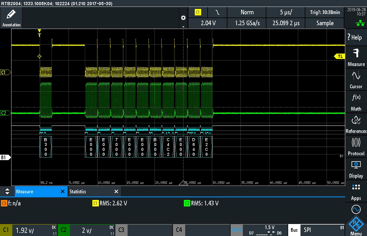

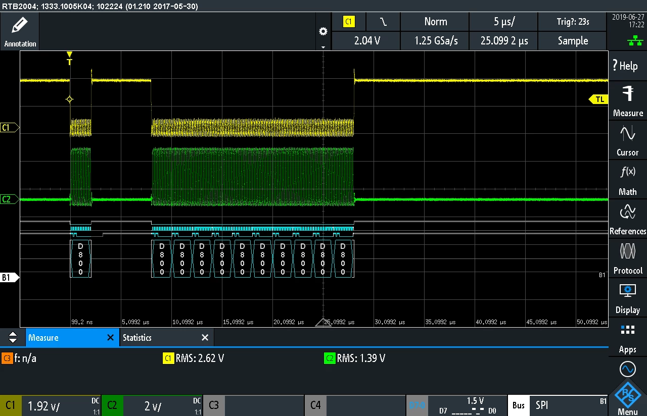

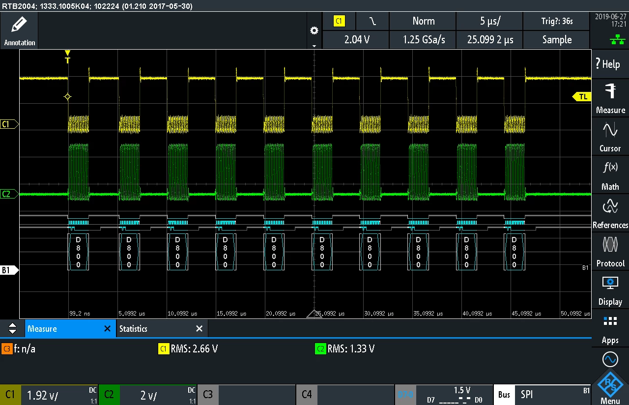

How can I generate pulse on NSS after each half word if I am reading the whole data in one shot or using DMA?
In the next picture NSS in Yellow and SCK in green, this is the required pattern, I get it when sending data one by one
and in the next picture 1st half word is sent in one command and after that I start DMA,
you can see that NSS is kept low during the whole data transmission

thanks @Community member​
it was the MIDI, I should use a value greater than 1
Here's the working configurations

Set nonzero SPI_CFG2.MIDI, read Slave select (SS) pin management subchapter of the SPI chapter in RM.
