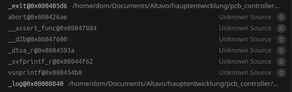

How to enable snprintf float?
I'm trying to snprintf into a data buffer, but the application dies precisely on this call. I'm not using nanolib because I want exceptions. My CMake file looks like this: Notice that I added the -u printf_float to the linker flags. Is this not all that is needed?
Thanks for any help!

This is what the call stack looks like, Note "_log" is is my function which calls the snprintf. All buffers as are and big enough and the format specificer is also correct "Some float value %f". Any ideas?
