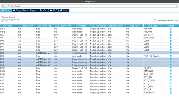

I need to enable interrupts for pins PJ0, PJ3, PJ4 and PJ5. Why these pins? Because they are connected to the ARDUINO connector (CN5 and CN6) of the STM32H7474I-DISCO board and they all seem to be all free. I have the initialization code (Hopefully right) but I have no glue how enable and handle the interrupts. Can anybody help?
__HAL_RCC_GPIOJ_CLK_ENABLE();
/*Configure GPIO pins : PJ0 PJ5 PJ3 PJ4 */
GPIO_InitStruct.Pin = GPIO_PIN_0|GPIO_PIN_5|GPIO_PIN_3|GPIO_PIN_4;
GPIO_InitStruct.Mode = GPIO_MODE_IT_RISING;
HAL_GPIO_Init(GPIOJ, &GPIO_InitStruct);

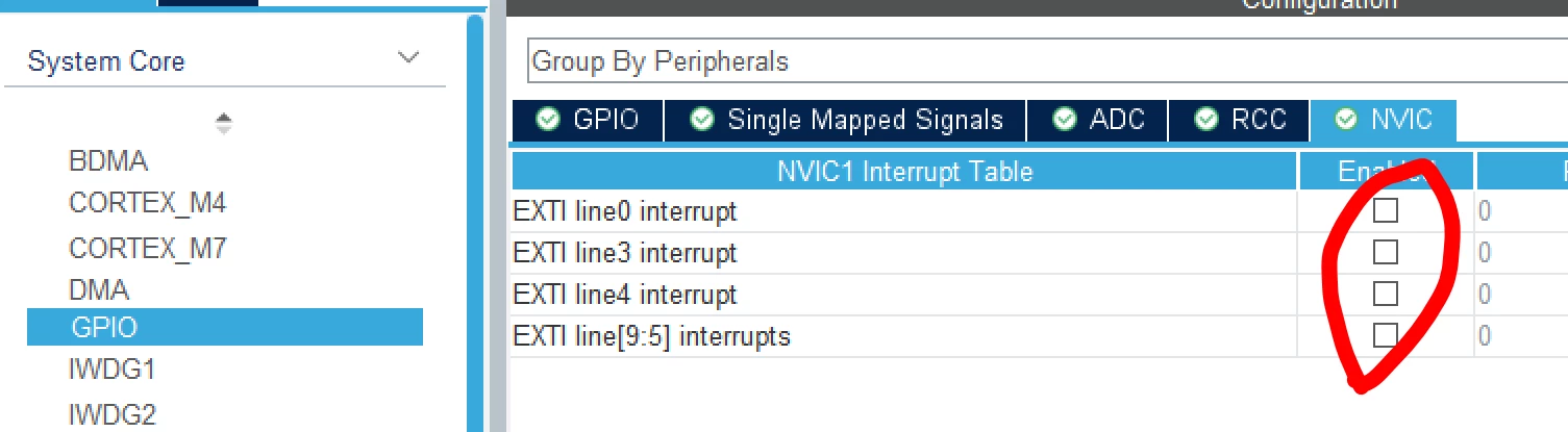

In GPIO, go to the NVIC tab and enable the interrupts.
Also, defining user labels with a "#" in the name is no recommended. Might work, might not.

I generated the app with CubeMX but it did not generate the interrupt setup and handlers. Here is the screenshot of CubeMX:
0693W00000D1KFtQAN.pngThanks again,
Louis
Aug 2, 2021 7:02 PM UTC
Are you sure? Where are you looking? Interrupts handlers are in *_it.c by default.
Post your IOC file if you can, or make a new one that exhibits the same behavior and post that.

Obvious, thanks! I will try that tomorrow morning.

Hi TDK!
Thank you very much, it is working just fine. Thanks for your help. I appreciate it very much!
