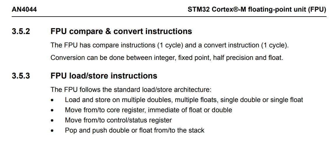

How to efficiently save and restore the 32F407 FPU context
STM should really post their code to handle FPU context saving and restoring BECAUSE their clients have been asking for over a decade!!!
One user stated "the time for a full FPU state save/restore is quite long. A pair of vpush {s0-31}/vpop {s0-s31} takes around 400ns on my STM32F407 @ 168MHz."
Without this our code suffers floats sticking at nan0x400 status after IRQs.
So, STM staff, come on, show us the best routine you have to save and restore the FPU status, because the Lazy FPU feature is useless!!

Hello @Robmar​
I come back to this old discussion and would like to mention that the FreeRTOS context switch routine is generic to any Cortex M4 with FPU. Here is an example how to save/store FPU registers in addition to lazy mode.
Added to that, ST provides this application note AN4044 section 3.5.3 FPU load/store instructions where we explained load/store instructions.
0693W00000aHKuWQAW.pngAlso, in Cortex-M4 Revision r0p0 Technical Reference Manual, you can find cycles counts of each instruction set.
It would be a good enhancement for our application note to include and detail the vpush/vpop instructions as load/store option for FPU. These instructions can potentially reduce the timing of FPU save/restore operations. (Any use case proposal from your side is welcomed, you can share your example privately if possible)
Thank you all for your constructive feedback.

There is no faster way than vpush/vpop and these instructions must take > 32 cycles, cause they execute 32 memory transfers. And I don't think there is anything wrong with lazy context switch, as most of ISRs do not need FPU. Just write your own FPU context switch handler - that's it.

Robmar
RobmarAuthor
Senior II
Feb 22, 2023 11:58 AM UTC
Thanks Firas, for the useful references, looks like it should be enough to complete two save and restore functions for the FPU. All the best
