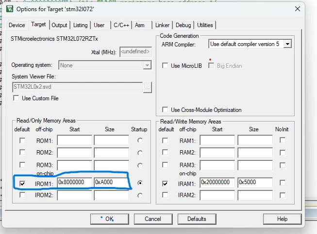

i belive suppose my application is running at address 0x08005000 so one this must be set is VECT offset which should be 0x5000 and also in keil in configure tool i have o set the the ROM1 start address which nothing but flash i believe and also its size otherwise it wont work ..i have attached the image of the configuration window
Here is my challange: i want to write this values start and size in code dyanamically so how can i achieve this in stm32l072.
if i will be able to do this then i can flash any bin file in ota withut hardcode vect offset table value and this config for ROM1 value .
also i checked but im not able to find this how to change this values in code files.

satyam9896
December 31, 2024
Tell me one thing there is codeA in which nothing but in while(1) LED will Toggle and code has offset table variable set as  0x00005000 and in keil configration setting the start address of IROM1 is : Start ->  0x0801C000 and size: 0xA000 you can see the photo of keil configration setting window above already i have shared. Now, I have compiled the code and generated bin file same Bin I will flash it at address 0x08005000 from mx cube programmer.

my doubt is after reset the code at 0x08005000 will run or not because in my case it is not running but the time i will set keil configration ROM1 Start setting as 0x08005000 and offset will be same as privious 0x0800500 ..the code will run ..led will toggle after reset.
why its so?

Have you basic knowledge about ASM and vector table in ARM ? Plus KEIL if i right rememmber have
default -fno-pic = code must be loaded on right place. But for your understanding offset in code 5000 and base 1C000 will never work.
void (*app_reset_handler)(void) = (void (*)(void))(*((volatile uint32_t*) (0x08005000+ 4U)));
when you load here code compiled for 1c000 , then here is 0x0801cxxx = code adrr for jump on reset, but you load it to 5000 then on addr is nothink loaded...
When you build with -fpic and realy require place this code to any possition then in main start you require copy vector table to RAM (or in bootloader but here you require reserve RAM for this otherwise is erased in init app)
and after copy recalculate every vector address to actual load possition . Ofcourse then set VTOR to ram.
