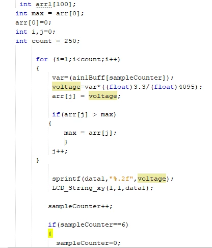

I have connected a sine wave of amplitude 3V with 1.5V shifted above the zero to 12-bit ADC channel by using dsPIC33FJ32MC204 controller and stored in an array. I want to detect the max value out of five samples because after the five samples my data is repeating, so please give me any suggestion on it. I am getting output as a zero.

sanjuBest answer
Sep 14, 2020 1:17 PM UTC
If(I<arrayLenght)
} This case is to fill the array with adc values
When array will be filled completely then
If(I==arrayLength)
} This section will find the max value
Because until the array is not completed no need to check for max value​
The code you want to write will never fill the array completely because
Each time i will be 0​
You have take another variable for the loop to do by your way
​array[i] =adc_value;​
     for(j=0;j<8;j++)
     if(array[j] > max)
     max = array[j];
sprintf(data1,"%.2f",max);
LCD_String_xy(1,1,data1);
max=0;
i++;​
     if(i == 8)
      i = 0;
This will work​

sanju
Sep 12, 2020 9:34 AM UTC
#define arrayLength 5
unsigned int array[arrayLength];                                //Array values should be updated with ADC values.
unsigned int i, max = 0;
void main()
for(i=0;i<sizeof(array)/sizeof(array[0]);i++)
if(array[i] > max)
max = array[i];
//here after the loop completion you can get the maximum value in variable max
You can find max number in a array by this way.
Mohan1
Mohan1Author
Sep 14, 2020 4:07 AM UTC
@sanju​ Thanks for your quick response sir and your logic is working properly and getting max value accurately but facing one problem that as data is real time ,so how can i take infinite data in array means how can i update array values with ADC values?
Thanks in advance.
sanju
Sep 14, 2020 6:14 AM UTC
First of all, you can't store infinite data in array because RAM size of your device is 2 KB. so you have to define arrayLength
#define arrayLength 5(you have to set it first).
suppose you have this define it as 8
then code like this
#define arrayLength 8
unsigned int i=0, max = 0;
void main()
while(1)
if(i<arrayLength )
//Read adc value and assign in array
array[i] = adc_value;
i++;
if(i == arrayLength )
if(array[i] > max)
max = array[i];
i=0;
i++;
// do your other tasks here
//Put some delay if required between adc samples.
