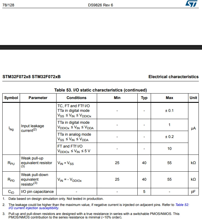

See the standard logic-level definitions for the pin - in the datasheet.
PS:
https://www.st.com/resource/en/datasheet/stm32f072rb.pdf#page=79
via: https://www.st.com/en/microcontrollers-microprocessors/stm32f072rb.html#documentation

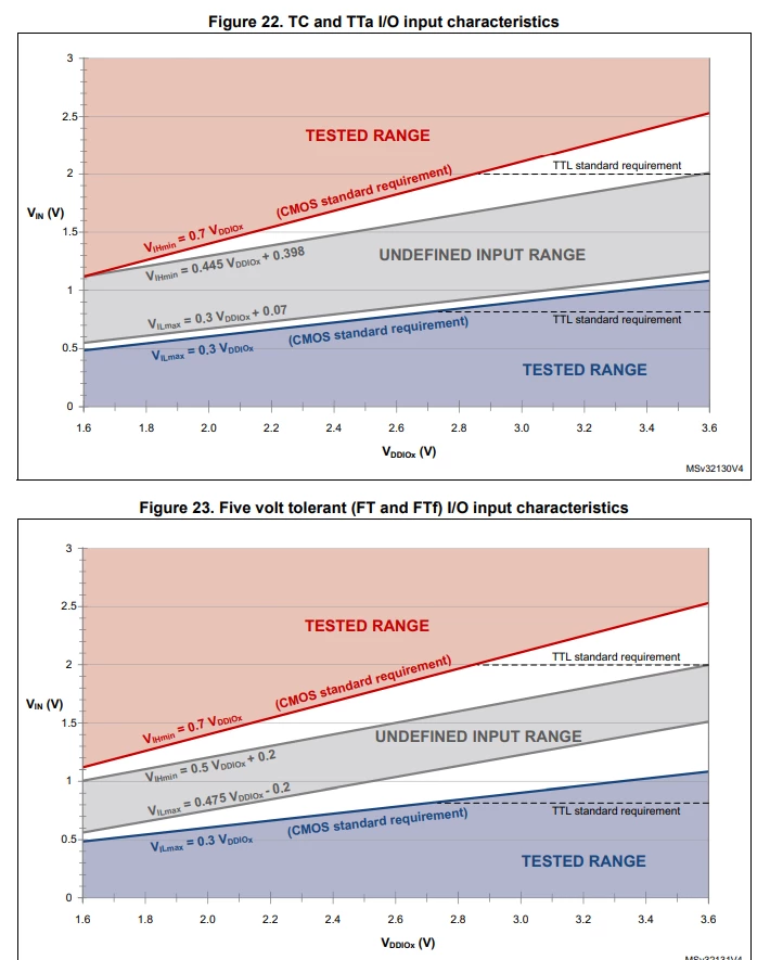

Henry1314Author
Apr 25, 2025 9:40 AM UTC
could please help find this value? I am confused by I/O voltage and rising edge voltage
Andrew Neil
Apr 25, 2025 10:03 AM UTC
"Rising edge" simply means a transition from a valid logic low level to a valid logic high level
 __________________ Logic High
Logic Low ______________|
 Rising Edge
