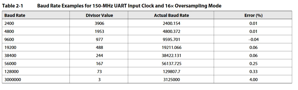

How should a UART interface be designed so that a robust communication possible can be established between two MCUs. The following table is shown in a data sheet from Texas Instruments. You can see the error rate depending on the baud rate.
0693W000007DYU5QAO.pngAccording to my research a low baud rate below 57600 bit/s and 16x oversampling is suitable for a communication over a longer distance.
1) Are the error rates manufacturer dependent?
I can't find any application notes from ST for implementing a reliable UART.
2) Are there any recommendations on which communication protocols should be used? (Something like TCP/IP over UART).

As mentioned previously that table you posted is for baud rate error%, not for data bit errors.

For long transmission lines, RS232 transceiver chips are used transforming the logic levels to V.28 levels. There are also optical transceivers and others kinds of robust serial transmission. So, the real error rates depend heavily on your overall transmission line.

The error in this table is the deviation from the target baud rate. The baud rate must be derived from a clock, which is 150MHz in the example, which in turn is probably generated from an external crystal using a PLL. If you calculate the error in the table yourself by using e.g. the values for the row 56000:
(150MHz/(16*Divisor*TargetBaudRate))-1
you will get the value 0.002459..., which you have to multiply by 100 to get the percentage value 0.25 (rounded).
The transmission distance for communication via UART is instead limited by the electrical behavior of RS-232 (search for keywords like distance or signaling). Depending on your definition of "longer distances" you should consider one of the alternatives mentioned there, e.g. a differential line like RS-485, which would just need another PHY like e.g. the STR485.
The communication protocol has nothing to do with the physical layer as it is part of a higher level in the OSI model. It only depends on your system requirements whether and which one should be used.
