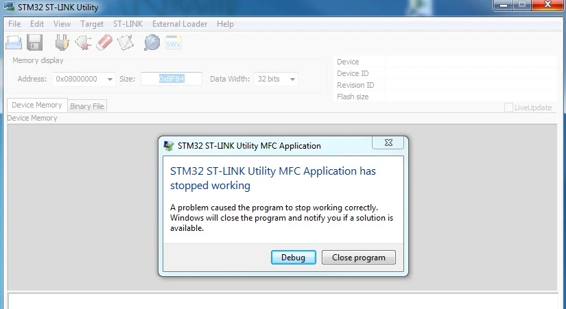

New.Fish
New.FishAuthor
July 6, 2020
After I try to debug two MCU in one PC, the STM32 ST-Link Utility doesn't work,
even I restart the PC, uninstall and reinstall the ST-Link Utility, it still fails.
