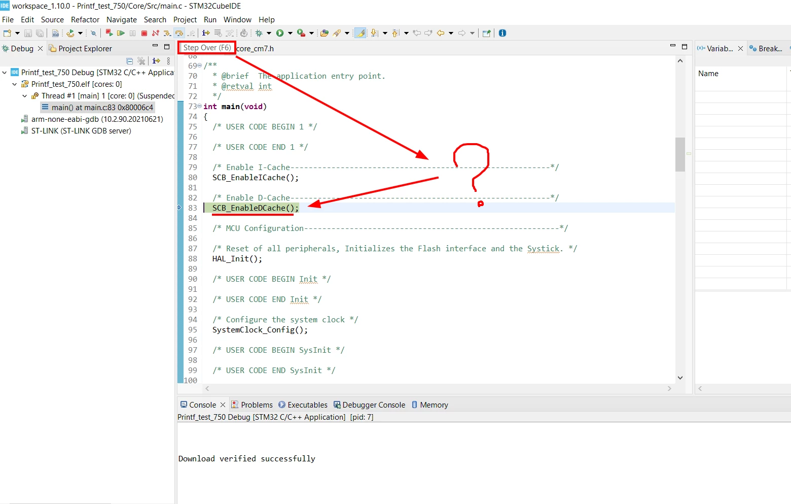

How to debug "STEP Over (F6)" SCB_ENABLEDCACHE ()?
  • June 29, 2022
  • 889 views
I trying to debug my simple "Blink" code by pressing "STEP Over (F6)" but it freeze every time at SCB_ENABLEDCACHE ();
But, if i press restart and "F8" (resume) everything working well!
 My stm is STM32H750VBT6.

Pavel A.
June 29, 2022
This is a known issue with the gdb..Just do not step on/thru this inline macro. Run thru it on full speed.
