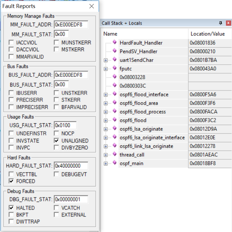

I found there is a Fault Reports in MDK as shown below with Call Stack. It can be seen that a Hard Fault is invoked and it is FORCED which means I should check other fault. Usage Fault is also invoked and it is an UNALIGNED access usage fault.
From the right of the above image, it can be seen that the call stack is very deep. Since uart1SendChar is tested before many times, so I guess somewhere of the new added ospf function may change the memory of others. Then, what should I do next to find which part of the code is wrong?
The following is the uart1SendChar code which is very simple. Then which memory of the following code is corrupted will cause the UNALIGNED access usage fault?

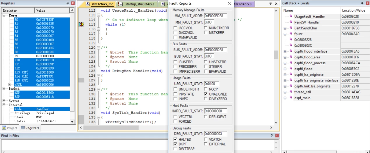

After I have check further with my hard fault, I found out that my hard fault is a FORCED one and is escalated by Usage fault which is UNALIGNED. The following image is the screen capture after I enable the Usage Fault. 0690X000006CHrCQAW.png
However, do you known how to find which line of code or which assembler instruction that cause this UNALIGNED fault?

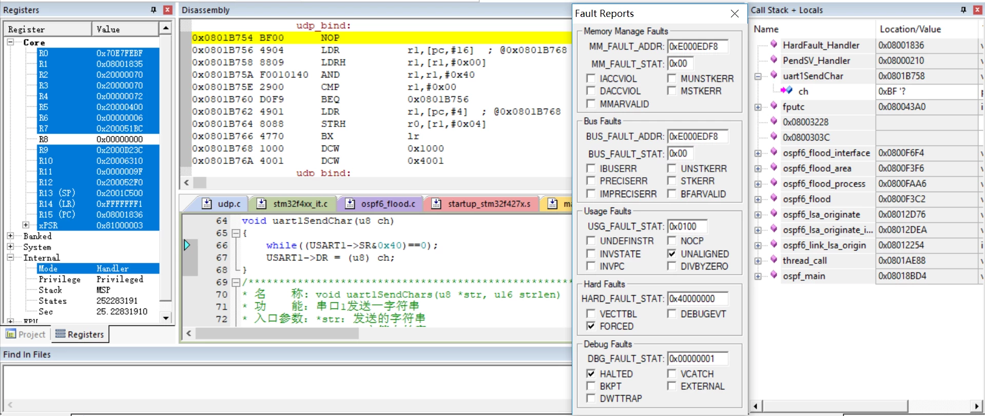

I am using Keil MDK IDE (with FreeRTOS and LwIP and OSPF routing protocol). The MDK call stack screen capture is shown in the following image.
The call stack shows that 0x0801B758 of uart1SendChar cause the UNALIGNED Usage fault.
The instruction at address 0x0801B758 is as follows which is used to get the value of USART1->SR:
0x0801B758 8809   LDRH     r1,[r1,#0x00]
Since the USART1 is a peripheral structure and SR (Status Register) is the first element, I cannot figure out how could this instruction cause the UNALIGNED Usage fault?
I also find a strange phenomenon. When the UNALIGNED Usage fault is caused, my uart output is as follows:
lwip_select: no timeout, returning 0
Interface Event et0: [InterfaceUp]Filter out Linklocal: FE80::200:D4FF:FE01:1/128Interface state change et0: Down -> Waitinglwip_select(4, 200062e8, 200062e4, 200062e0, tvsec=0 tvusec=0)
No retr
If I set a breakpoint in the uart1SendChar function before "No retr" is printed. Then, one letter after another, the whole sentence can be printed as follows:
No retransmission scheduled, next interface
However, if I run again without any breakpoint, the UNALIGNED Usage fault will also be triggered in another place.
How could the UNALIGNED Usage fault disappear when there is breakpoint? I am very confused.
yanhc
yanhcAuthorBest answer
November 1, 2018
Finally, after I have changed the task stack size of the new added OSPF task from 500 to 2000, everything goes fine. However, I still cannot figure out how could task stack overflow cause the above strange phenomenon.
