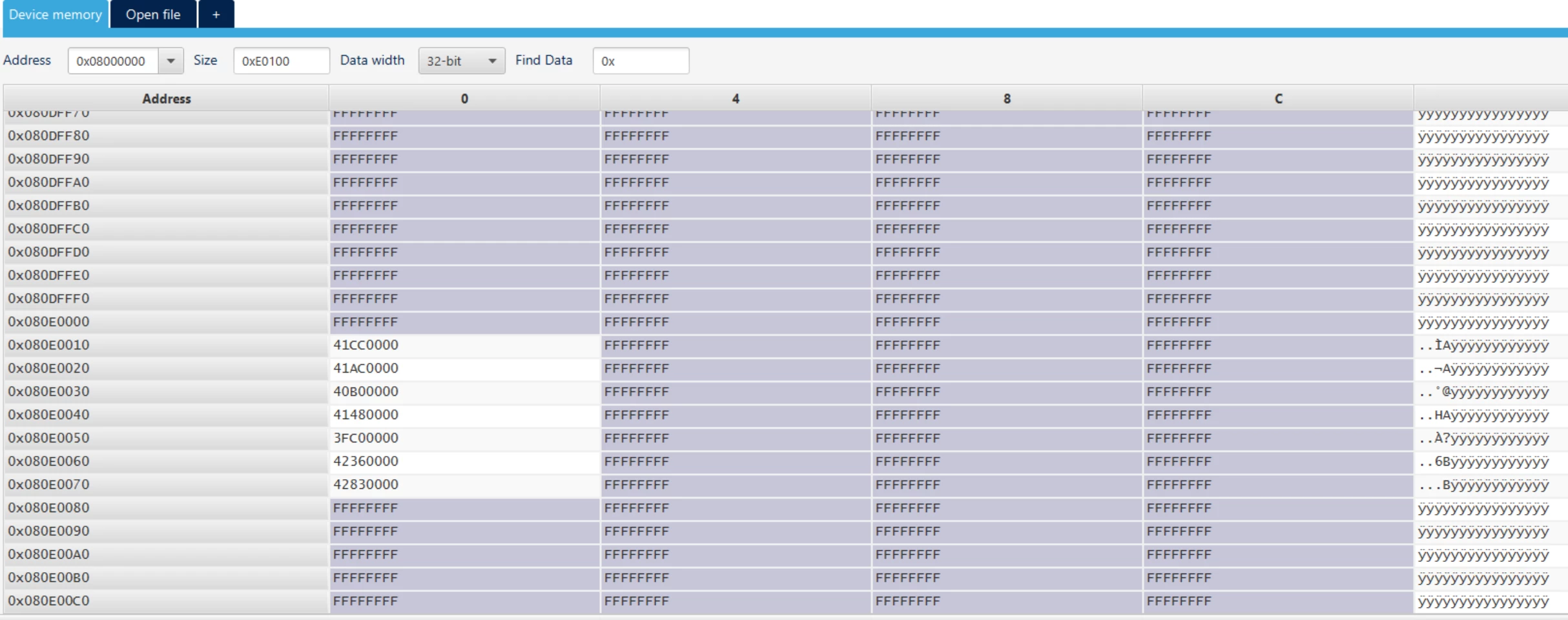

Are you suggesting that if I try to write 4 bytes one byte at a time to unaligned addresses I will have no problem, but if I try to write 4 bytes (32 bits) at once to unalligned addresses it will not work?
Karl Yamashita
Principal
September 12, 2024
You're incrementing by decimal 10 so you're not aligned correctly. Try hex 0x10, 0x20, 0x30, etc..

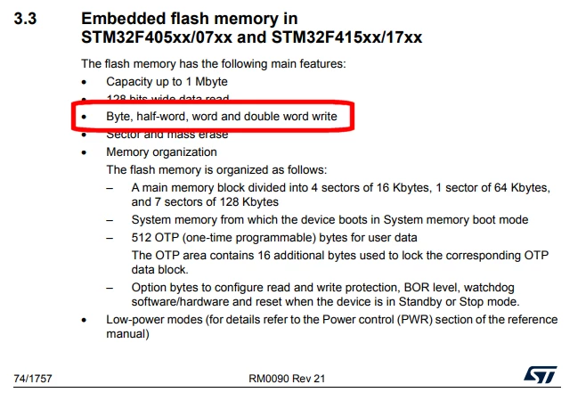

Andrew Neil
September 12, 2024
The RM does say that byte, half-word (16 bits?) word (32 bits?) and double-word (64 bits?) should all be possible:

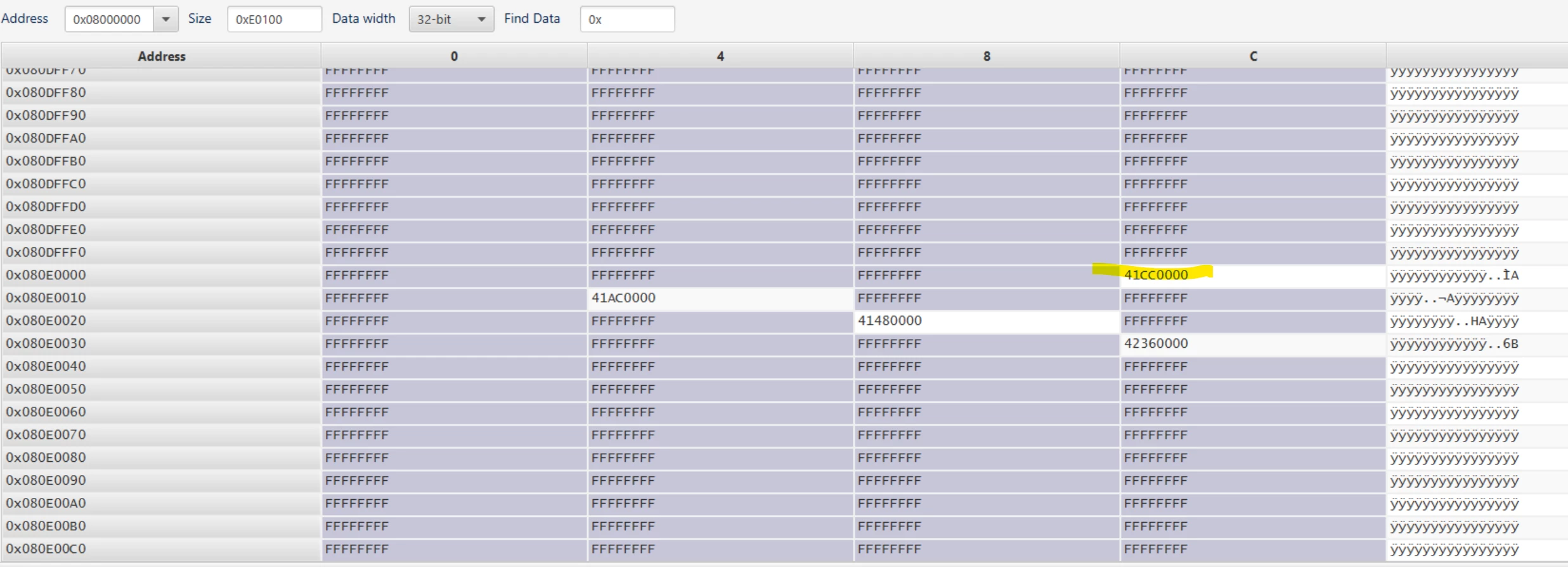

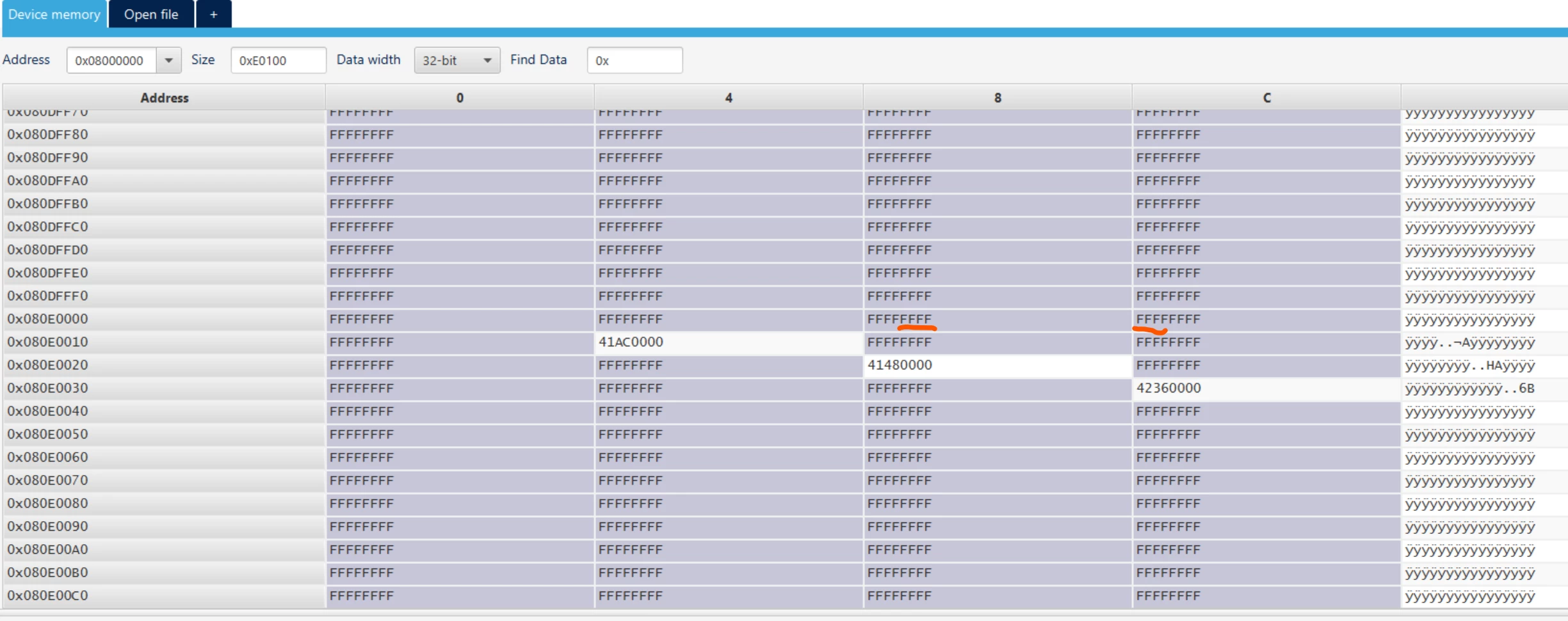

Karl Yamashita
Principal
September 12, 2024
@Andrew Neil Yes you can still write as a word or any of the other writes, but it still has to align to within a column. Right now the OP is trying to write part of his float in column 8 and C when he use decimal 10, 20, 30, etc. In this case for decimal 10, it fails to write anything and still shows 0xFFFFFFFF
Here is when writing at SECTOR_11_START + 12 which is now aligned in a column and not overlapping into another column. So in this case it does write the value in flash correctly.
I originally thought the OP was trying to increment the address so it would align like this. So I told him to use hex 0x10, 0x20 and so on
