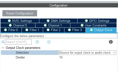

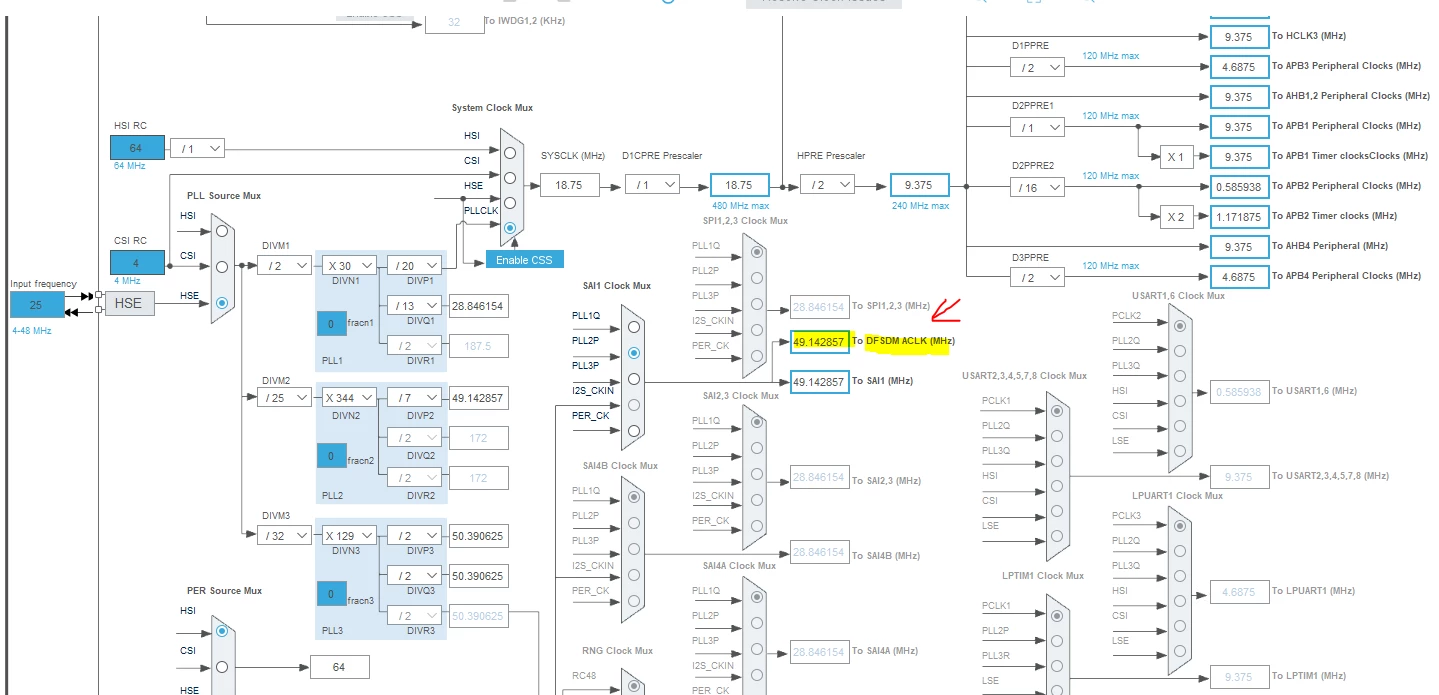

Hello everyone,
I think that I am missing some parameter in my calculation. I want to feed the clock to a microphone and I want the output clock to have a frequency of 48kHz x 64 = 3.072MHz. The 48kHz is the audio sampling freq and 64 is the decimation factor on the filter side. But I keep getting wrong frequency when I measure it with oscilloscope.
Btw, I am using Nucleo-144 STM32H743
I know the formula look like this (But somehow this is not true):
Decimation factor x Audio sampling freq = DFSDM clock source / Divider
And below are the details:
  • DFSDM Clock source: Audio Clock
  • Decimation factor: 64
  • Audio Sampling freq: 48 kHz
  • DFSDM Clock Source: 49.152 MHz
  • Divider: 16
Output Clock that I want (DFSDM1_CKOUT): 3.072 MHz
Output Clock that I got (DFSDM1_CKOUT): 978 kHz
What am I missing here? And is the formula correct? I also include screenshot from MXCube.
Hope someone can help me. Thanks in advance.

Hey, so, first, some reference :
From the second link the formula (just for the PDM mic) is : Fs = decimation * PDM_clock
What I would try is changing the source from audio clock to system clock, because audio clock actually refers to another peripheral (independent from DFDSM - first link)

Hello @Community member​ and welcome to the STM32 Community,
Have a look at this section: "DFSDM peripheral configuration tutorial", in the DFSDM application note: AN4990 "Getting started with sigma-delta digital interface on applicable STM32 microcontrollers". This will help you on the DFSDM configuration.
