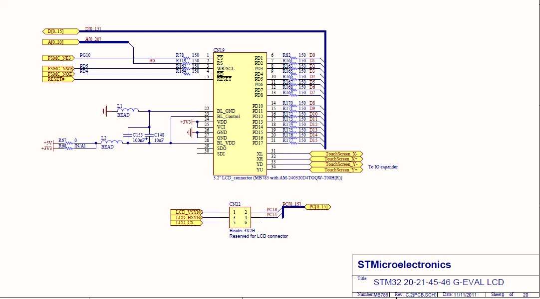

Hello ​@Sathish_Sulthan and welcome to the ST community,
Such kind of question formulation doesn’t help to converge into a solution.
What do you mean by “LCD parallel display”, is it over FMC, or LCD-TFT interface (LTDC)? both are parallel interface.
If it’s over LCD-TFT please refer to the application note: AN4861 “Introduction to LCD-TFT display controller (LTDC) for STM32 MCUs”
If over FMC, you need to connect it as an external SRAM. I invite you to inspire from the STM32F4G-EVAL:
Unfortunately there is no hardware example with STM32H7. But they have the same philosophy.
Be careful, with STM32H7 and an LCD connected over FMC, you should configure LCD address region as Device or Strongly-Ordered using MPU, otherwise you’ll face communication and rendering issues with the LCD.
Please refer to this thread:
Hope that helps.
