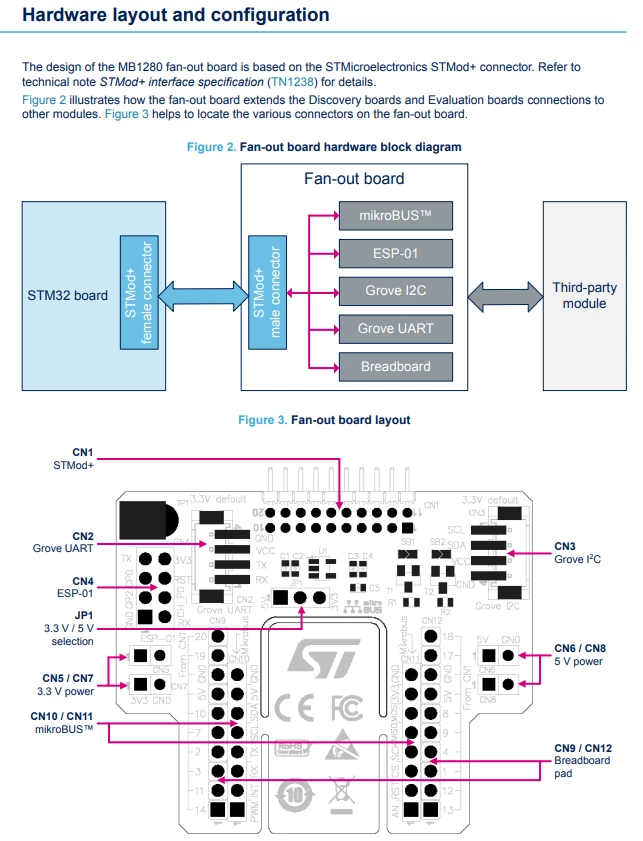

_legacyfs_online_stmicro_images_0693W00000bk0g7QAA.pngESP-01 is supported on fanout expansion board, how to connect WIFI and send message in local area network? Is there any example?

Thanks!! I want to add this in my ai-vision project.
It do image classification task now, and I want to add sending result through WIFI.(PC or mobile phone, only need text can be sent)
I met some problem:
The AT command seems to need ESP01 module connected to PC directly, but I don't have connector. Can I put AT command in my AI vision project and let my stm32 board control the module?
And what's the specific code? I plug it at expansion board CN4.
AScha.3
May 13, 2023
no PC - just serial connection. read the manual, whats serial connected from H747 to CN4 . should be a usart or uart.
_legacyfs_online_stmicro_images_0693W00000bk0qWQAQ.pngthen send serial commands...thats it.
