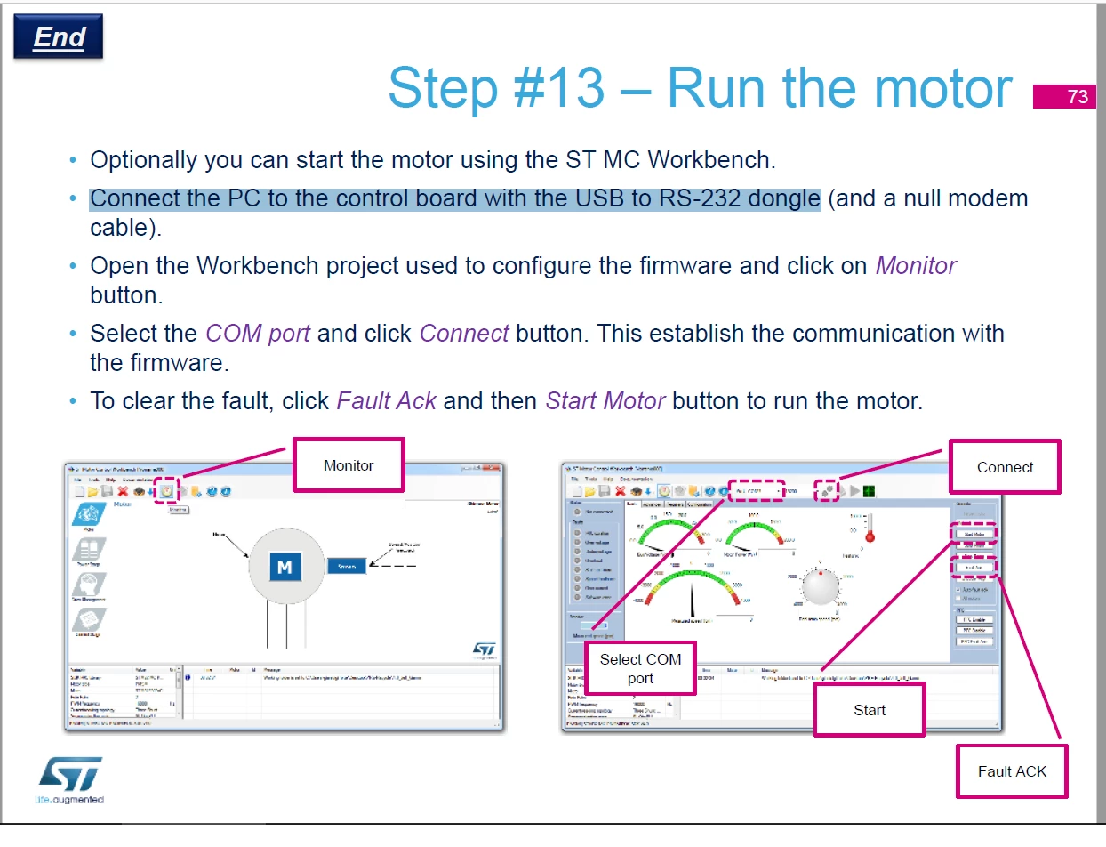

I am new to ST FOC library. I started my project of FOC motor controller. I've setup parameters with ST MC WB, compiled the codes and downloaded it into target controll board. Now I need go back to ST MC WB, to start the monitor to play the motor. I got no idea how to connect my PC to target control board via a USB to RS-232 dongle, so I can't start the monitor within ST MC WB. I need to know what port on the target control board shall be connected to the dongle, and does it need to be configed pror. I read 'FOC hands on' from the 'documantation' menu in ST MC WB but got no help.
