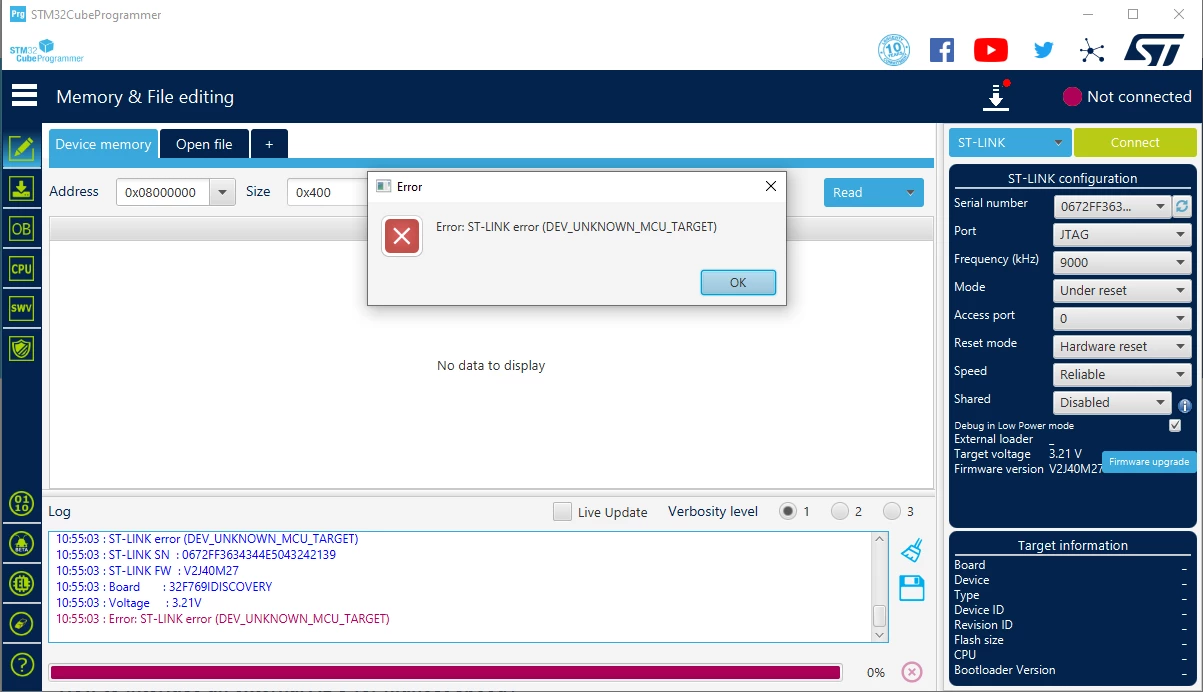

Hi all, I need to flash SBSFU to STM32F769I - Disco via JTAG. While I try to connect to the board via JTAG, the following error shows up.
_legacyfs_online_stmicro_images_0693W00000bkdEgQAI.pngDo I have wrong configuration settings or is there any other problem?

    Hello @MdFayaz​ ,
    Check the cable. Check the pins/connectors according the AN4661 Getting started with STM32F7 Series MCU hardware development (Internal pull-up and pull-down on JTAG pins" section)
    Imen

    Thanks @Imen DAHMEN​, the shared document was useful. And I went through some more documents and came to know that STM32 F769I Discovery board does not have JTAG port (has only SWD)
    May 23, 2023
    The Workaround is to use the SWD port instead of JTAG port.
