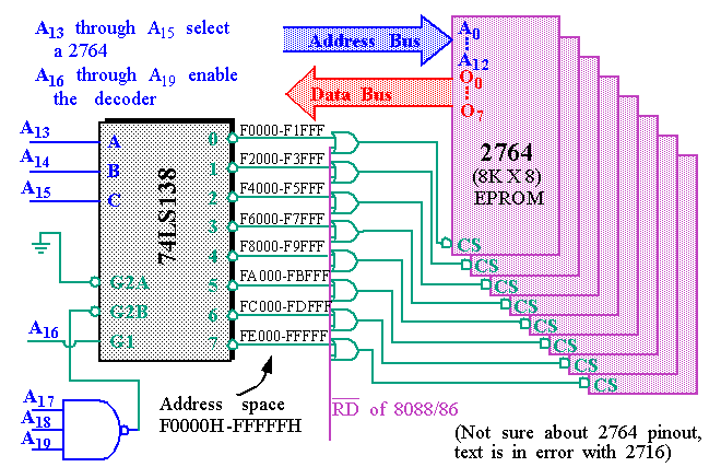

I want to connect 8 SRAMs (2MB) to STM32H755XIH3 and use them as 16MB work memory.
When connecting 8 memories (SRAMs) using FMC (devices more than the number of FMC_NE*), how should I connect and control them? If there are any similar cases, I would appreciate your advice.
I am currently considering it, but I have some conditions.
1. I will use Infenion's CY7C1061GE30-10BVJXIT (2MB) with dual chip enable for the SRAM.
2. Of the 4 NEs in the FMC, 2 will be used to connect other memories, so only 2 can be used for SRAM.
Thank you in advance.

@kazutobi wrote:
The SRAM I'm trying to use has two chip enable terminals.
I was thinking of doing it without a decoder. I don't know if that's possible though.
Two chip enable is to enable the memory itself.  You need to use one and fix the another. You need as @Tesla DeLorean said an address decoder like the old TTL "74138" to address 8 memories. Each 74138 output will drive a chip enable of a memory. The address decoder is driven by the Higher address lines.
This is an old concept. So for example this link: https://ece-research.unm.edu/jimp/310/slides/8086_memory2.html

You'd need to use 3 of the high order address bits to create a 3-to-8 decoder to generate chip selects for the individual memories.

mƎALLEmBest answer
September 6, 2024
