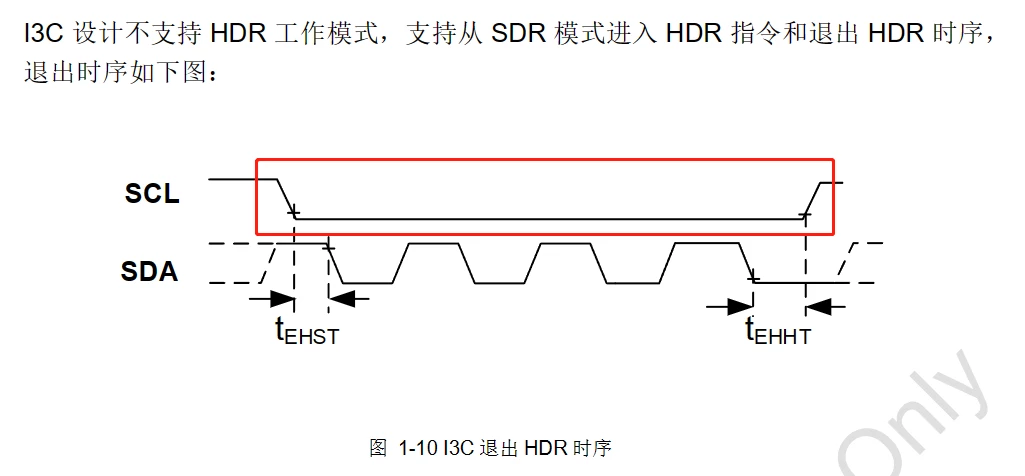

I am using the following slave device for I3C reading and writing. I can now read and write CMOS registers through private mode, but I cannot find any examples of entering and exiting HDR mode. Can you provide an example program for entering and exiting HDR mode? Thanks

Hello @taylor_quan ,
- HDR exit pattern generation on the I3C bus for error recovery.
You can enable the HDR exit via the I3C_CFGR register : [ Bit 4 EXITPTRN: HDR exit pattern enable (when I3C acts as a controller) ]

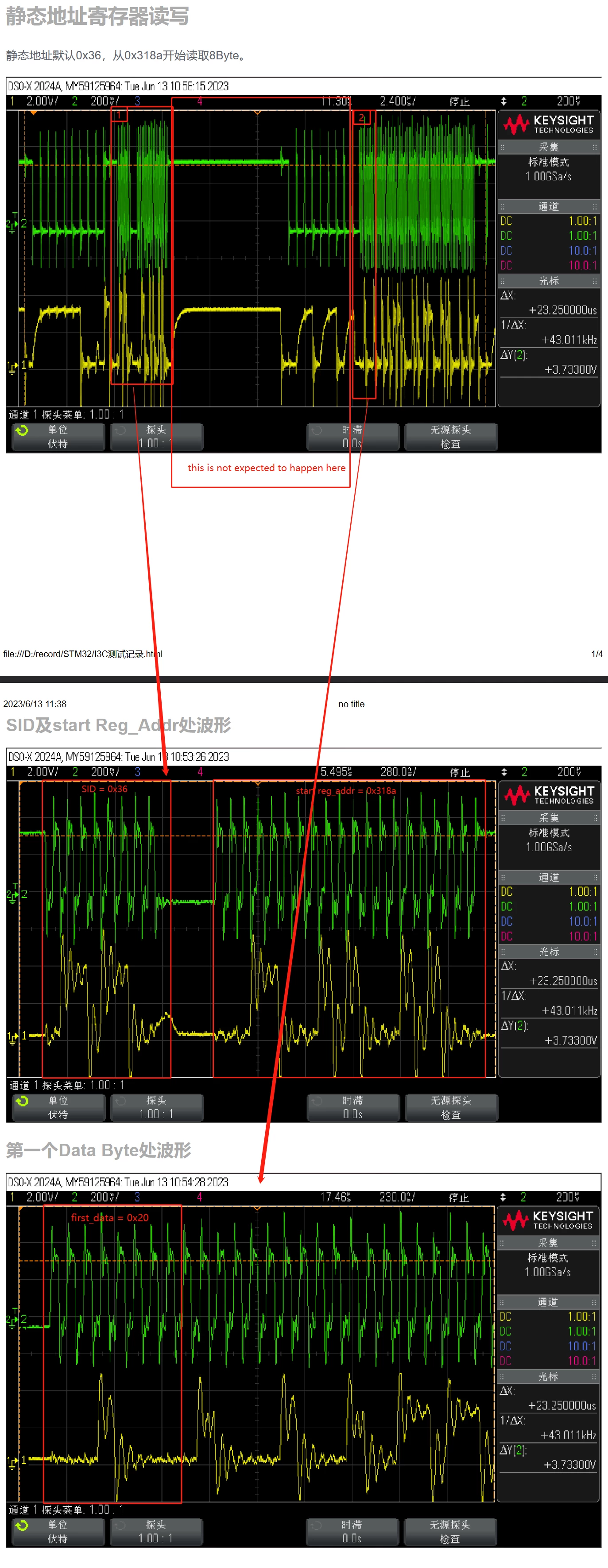

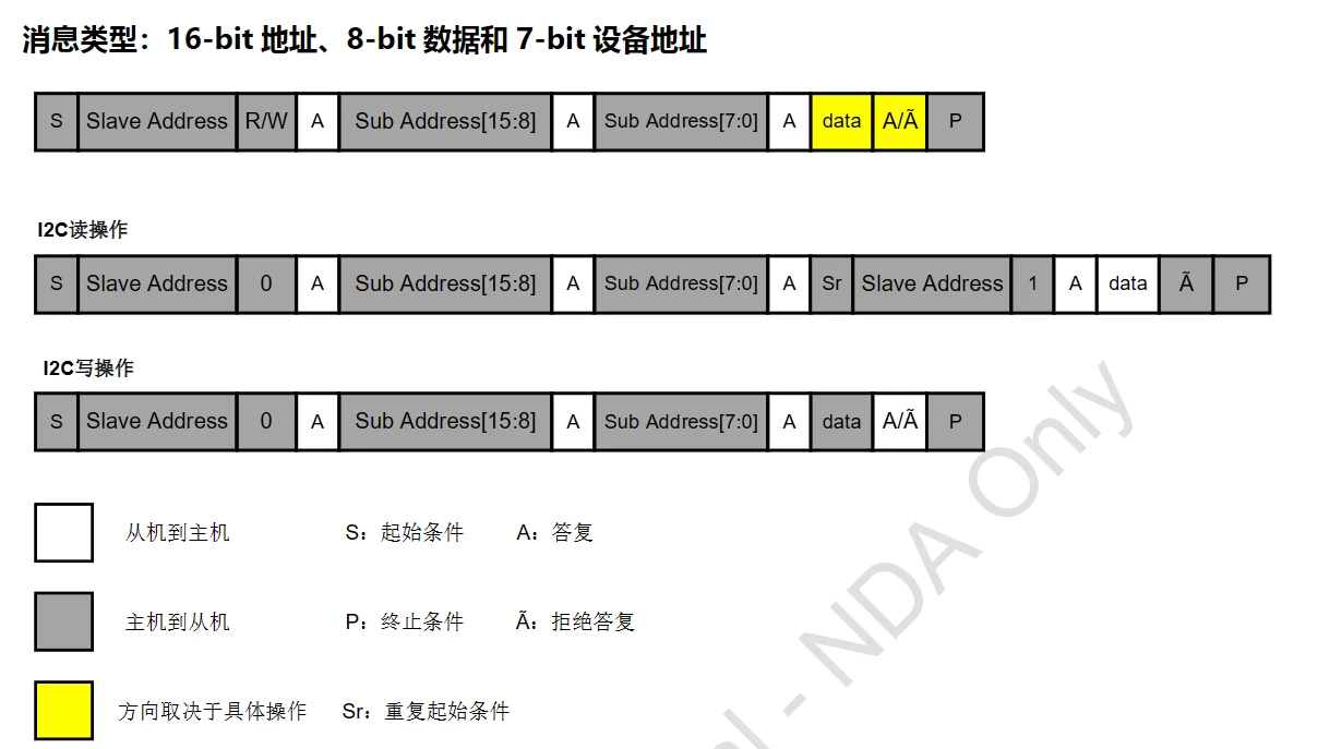

Another issue is that I cannot cancel the reserved byte when using private read
I3C_PrivateTypeDef aPrivateDescriptor[3] = \
 {TARGET1_DYN_ADDR, {aTxBuffer, 2}, {NULL, 0}, HAL_I3C_DIRECTION_WRITE},
 {TARGET1_DYN_ADDR, {NULL, 0}, {aRxBuffer, 30}, HAL_I3C_DIRECTION_READ},
											{TARGET1_DYN_ADDR, {aTxBuffer, 2}, {aRxBuffer, 30}, HAL_I3C_DIRECTION_BOTH}
