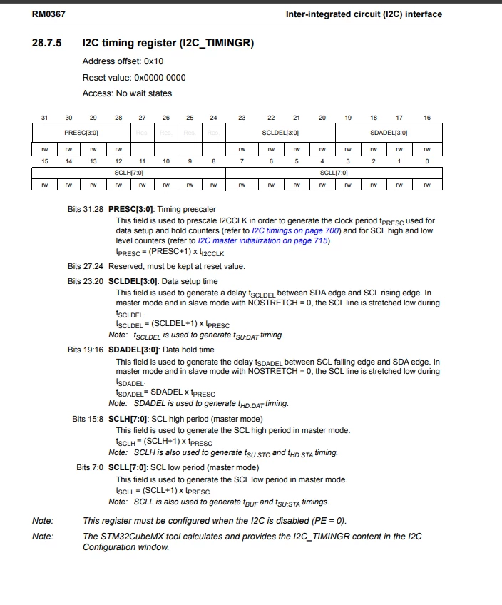

How to configure I2C_TIMINGR for STM32L073RZT6?
Timing.pngI2C_TIMINGR is configured for I2C bus speed of 400kHz. Is his configuration correct?
  • PRESC[3:0] = 0010 (PRESC = 2)
  • SCLDEL[3:0] = 0001 (SCLDEL = 1)
  • SDADEL[3:0] = 0001 (SDADEL = 1)
  • SCLL[7:0] = 00001010 (SCLL = 10)
  • SCLH[7:0] = 00001010 (SCLH = 10)
Is it correct or not?
