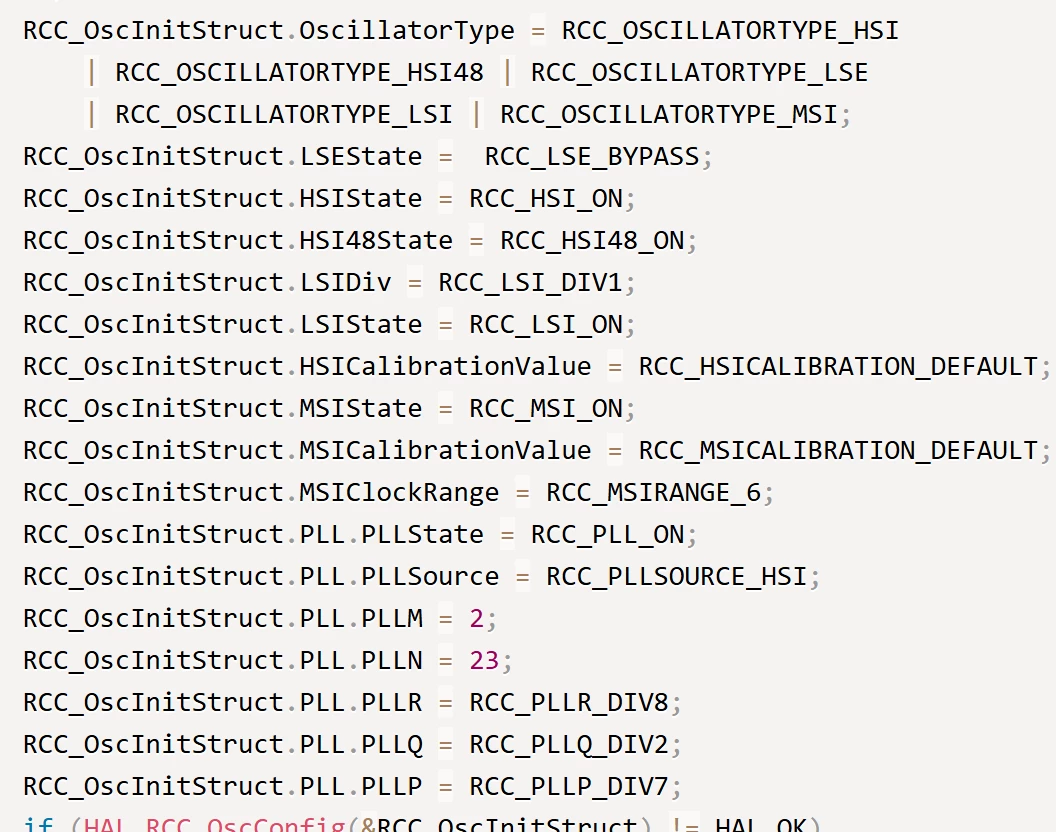

I would like to know if it's possible to configure my evaluation board HSI, I have this code and I would like to adapt it on my evaluation card and see if it is compatible with the rest :
// HSI
void SystemClock_Config(void)
 RCC_OscInitTypeDef RCC_OscInitStruct =
	0
 RCC_ClkInitTypeDef RCC_ClkInitStruct =
	0
 if (HAL_PWREx_ControlVoltageScaling(PWR_REGULATOR_VOLTAGE_SCALE0) != HAL_OK)
	Error_Handler();
 RCC_OscInitStruct.OscillatorType = RCC_OSCILLATORTYPE_HSI
	 | RCC_OSCILLATORTYPE_HSI48 | RCC_OSCILLATORTYPE_LSE
	 | RCC_OSCILLATORTYPE_LSI | RCC_OSCILLATORTYPE_MSI;
 RCC_OscInitStruct.LSEState = RCC_LSE_BYPASS;
 RCC_OscInitStruct.HSI48State = RCC_HSI48_ON;
 RCC_OscInitStruct.LSIDiv = RCC_LSI_DIV1;
 RCC_OscInitStruct.LSIState = RCC_LSI_ON;
 RCC_OscInitStruct.MSIState = RCC_MSI_ON;
 RCC_OscInitStruct.MSICalibrationValue = RCC_MSICALIBRATION_DEFAULT;
 RCC_OscInitStruct.MSIClockRange = RCC_MSIRANGE_6;
 RCC_OscInitStruct.PLL.PLLSource = RCC_PLLSOURCE_HSI;
 RCC_OscInitStruct.PLL.PLLM = 2;
 RCC_OscInitStruct.PLL.PLLN = 23;
 RCC_OscInitStruct.PLL.PLLR = RCC_PLLR_DIV8;
 RCC_OscInitStruct.PLL.PLLQ = RCC_PLLQ_DIV2;
 RCC_OscInitStruct.PLL.PLLP = RCC_PLLP_DIV7;
	Error_Handler();
 RCC_ClkInitStruct.ClockType = RCC_CLOCKTYPE_HCLK | RCC_CLOCKTYPE_SYSCLK
	 | RCC_CLOCKTYPE_PCLK1 | RCC_CLOCKTYPE_PCLK2;
 RCC_ClkInitStruct.APB1CLKDivider = RCC_HCLK_DIV1;
 RCC_ClkInitStruct.APB2CLKDivider = RCC_HCLK_DIV1;
 if (HAL_RCC_ClockConfig(&RCC_ClkInitStruct, FLASH_LATENCY_5) != HAL_OK)
	Error_Handler();
 /** Enable MSI Auto calibration
 HAL_RCCEx_EnableMSIPLLMode();
 /** MCO configuration
 HAL_RCC_MCOConfig(RCC_MCO1, RCC_MCO1SOURCE_SYSCLK, RCC_MCODIV_1);
 //__HAL_RCC_PWR_CLK_ENABLE();
With the .ioc file, it's better for understanding.
Thank you for your helps.

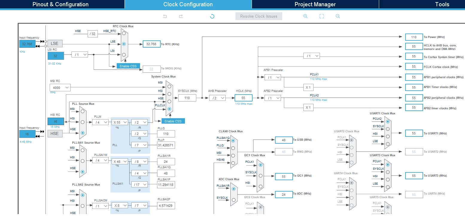

My board is STM32L552E-EV with STM32L552ZE MCU, yes in the example is the same microprocessor. I have this tab so how can I generate identical code in the example ?
How to select the HSI and configure the clock system to have the same code ?

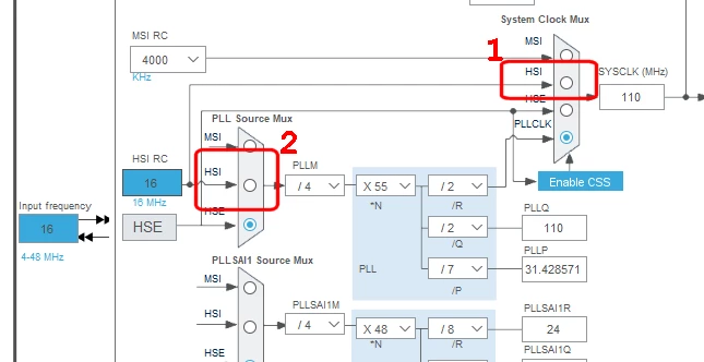

Andrew Neil
December 20, 2024
@DYann.1 wrote:
How to select the HSI ...
As you can see in the diagram, you have two options:
  1. You can use it direct
  2. You can use it via the PLL
@DYann.1 wrote:
... and configure the clock system to have the same code ?
Just make the settings the same as in that example.
December 18, 2024
Look at the values set by the code and duplicate those settings within the Clock Configuration tab in CubeMX.
If you're stuck, explain what you're stuck on along with a screenshot of your clock configuration screen.
HSI is configured on by default, but it seems like you want to configure the PLL as well based on your post.

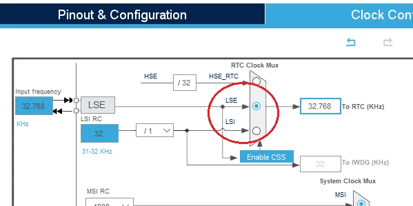

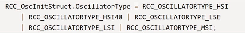

first, I would like to have these 5 lines,
And after trying several options it seems to me that it's impossible to have LSI and LSE at the same time
Did I miss something ? Here is my configuration in this attached, can you tell me where the errors are ? Thank you
PJ : _HSI_conf.zip
December 20, 2024
What you have circled in the RTC clock selection. You can't have the RTC run from LSE and LSI at the same time.
If you use LSI somewhere in the system it will be automatically enabled in CubeMX.
