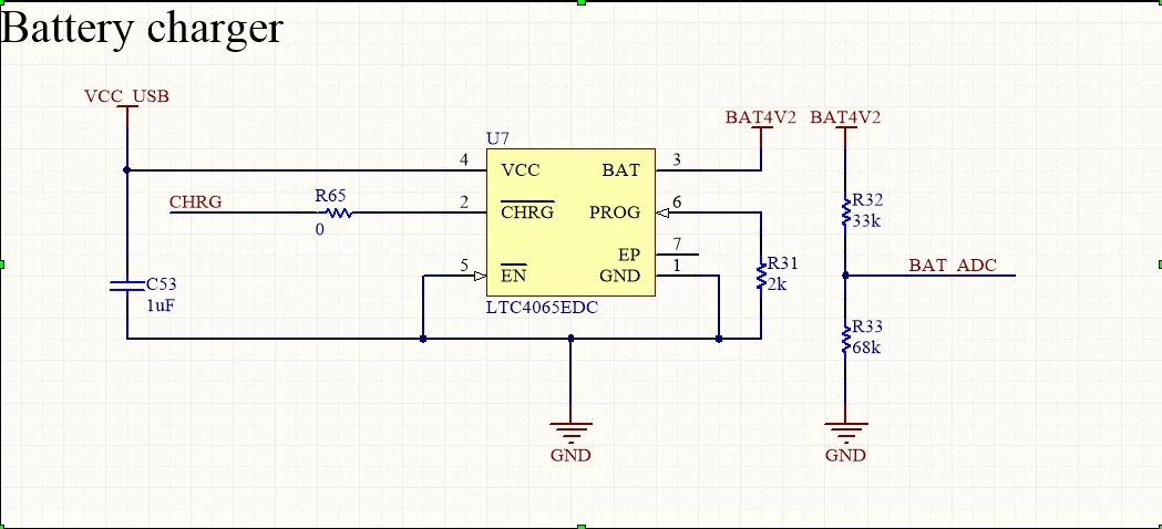

Good day,
What I want is:
If I put GND to GPIOD_4 I want to LED ON.
If high impedance then LED OFF.
I attached my schematic with CHRG pin connected to GPIOD_4.
Is it possible to pull up internally gpio?

    Hi
    kovaliov.nikolaj,
    If an input is configured with an internal pull-up, it will be high unless it is externally driven low.
    The converse is true with pull-down inputs.

    Posted on November 17, 2016 at 09:40
    Ah, i tested it on discovery board on which PD4 pin is connected to CS43L22 RESET pin which is R43 10k pulled low. So thats why it did not worked for me.
    Modified code abit which worked.
