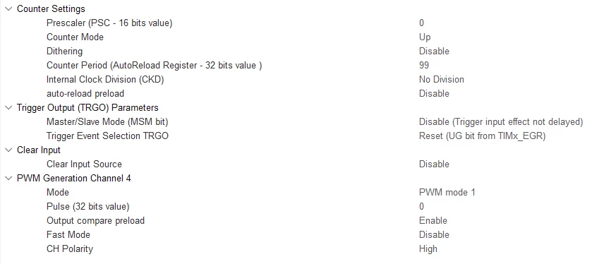

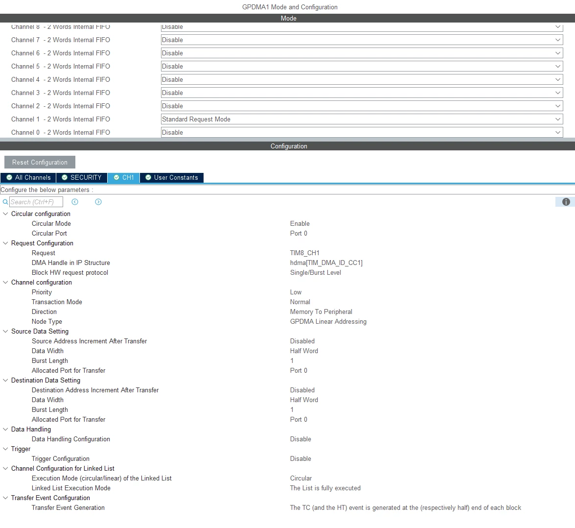

I'm using a Riverdi RVT50HQSFWN00 Screen with the STM32U5A9NJH6Q MCU. COnnected to pin PI0 is a WS2812 LED light strip. I already configured the timer 5 channel 4 for PWM generation and validated it with a scope at the pin. Right now I'm stuck at the GPDMA part. I'm able to start the PWM generation using: HAL_TIM_PWM_Start_DMA(&htim8, TIM_CHANNEL_1, (uint32_t *)pwmData, indx);
For the code I followed this tutorial: https://controllerstech.com/interface-ws2812-with-stm32/
This is my timer configuration (TIM5 global interrupt enabled):

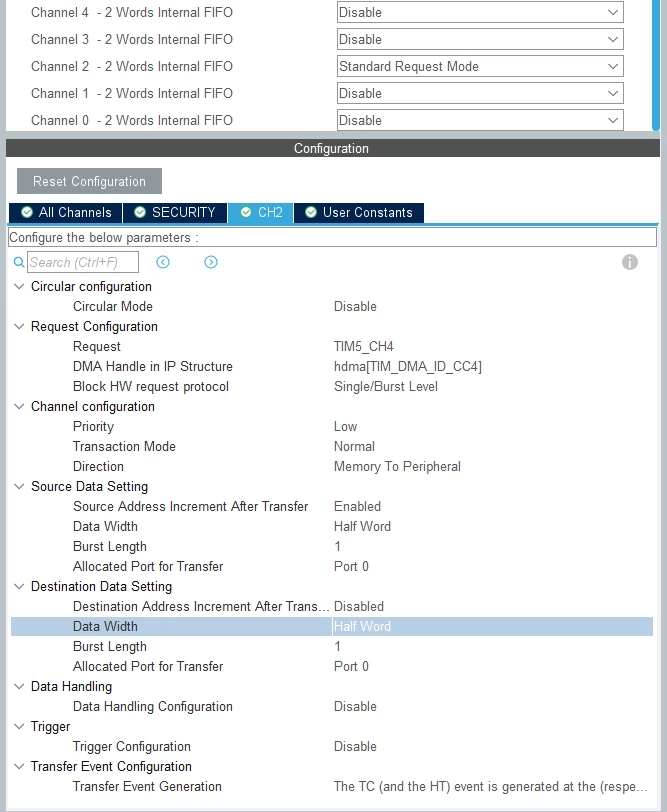

This is GPDMA configuration:
Using a scope, I see that a PWM signal is generated but the HAL_TIM_PWM_PulseFinishedCallback() function is never called, which in the end, stops the DMA transfer.

In your GPDMA configuration, in the destination data setting, try enabling the destination address increment after transfer
m4rk0401Author
January 9, 2025
Thanks @Sarra.S for your quick response. I tried your suggestion without success.
Timer configuration is the same because basic PWM generations works.

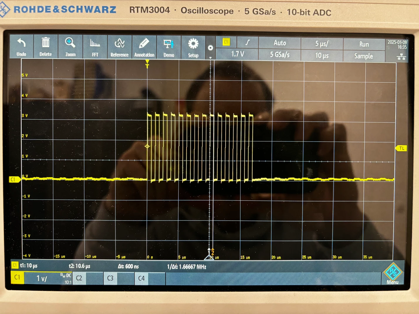

Unfortunately is set 24 different duty cycles in my code and get following result using a oscilloscope:
Any idea why only 14 cycles are outputted?

We had a similiar error with GPDMA. What helped us, was changing Data width to "Byte" in Source data setting and destination data setting in GPDMA configuration. Also then you have to change
uint16_t pwmData[24];
to
uint8_t pwmData[24]
