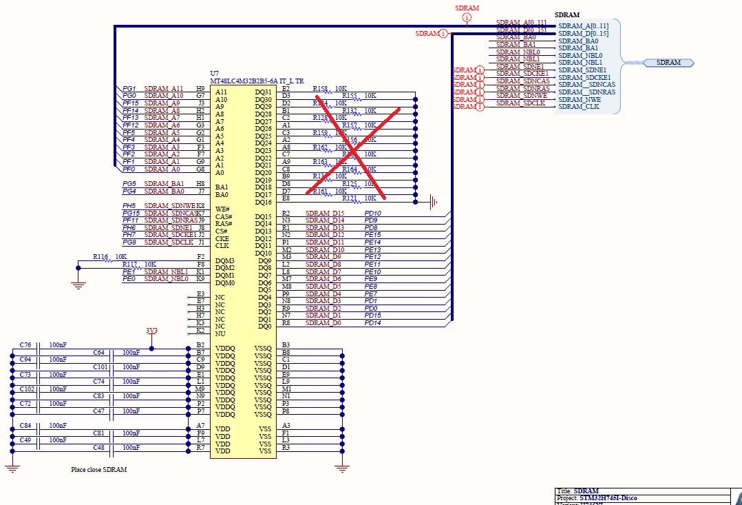

Sorry If you need 32-bit mode with an LQFP package you need to select LQFP208
mƎALLEm
March 26, 2024
As stated before, STM32H745IITX (LQFP176 package) can support only SDRAM up to 16-bit.
Regarding your second question, the SDRAM driver of this board (BSP) is already available from here. But again only SDRAM in 16-bit mode is available with this board:

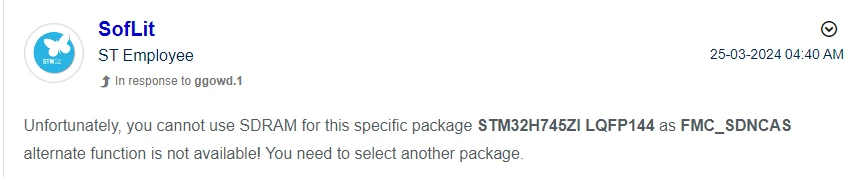

1. Can you provide steps for STM32H745I-DISCO Board also how to create a project for SDRAM configuration in STMCUBE_IDE.
2. Why SDRAM cannot be configure with STM32H745ZIT6 (LQFP144 package)? Can you provide the reason?
Use CubeMx and try to follow the parameters already available in the BSP.
Already answered that question:
