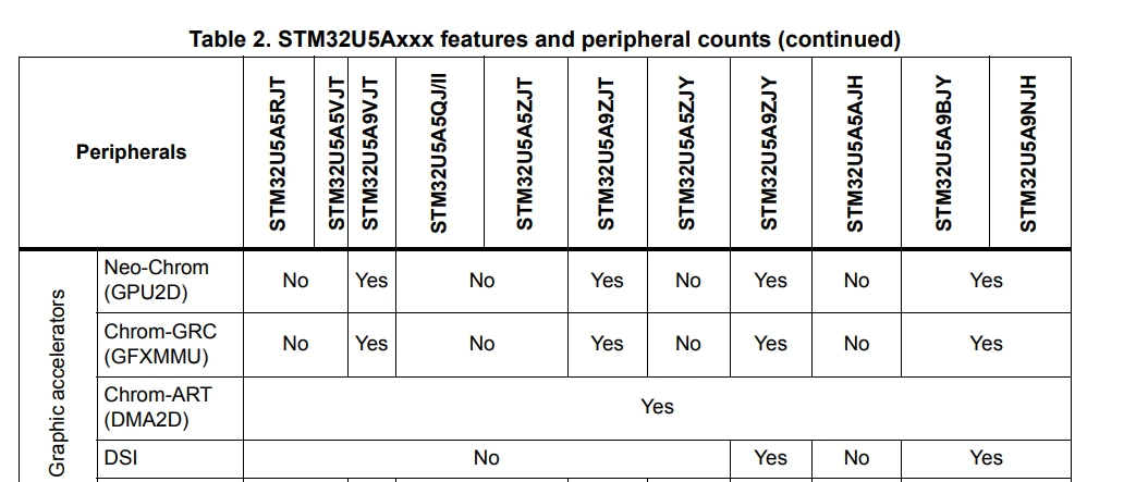

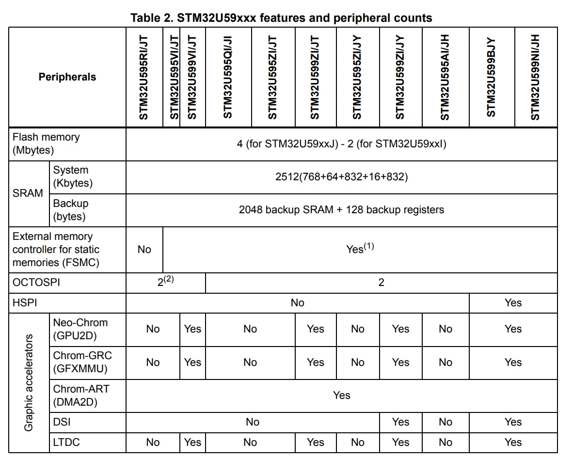

For the STM32U5x9, the lowest pin package can support the DSI is 144-pins.
As already mentioned to check the availability of DSI feature, please refer to the datasheets DS13543 and DS13633  table 2.

Note that this DSI feature is not available in all STM32U5x9 MCU package, please refer to the datasheets DS13543 and DS13633  table 2.

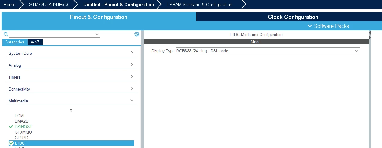

If the DSI is available you can configured it as shown in the below figure:
Thank you.
Kaouthar

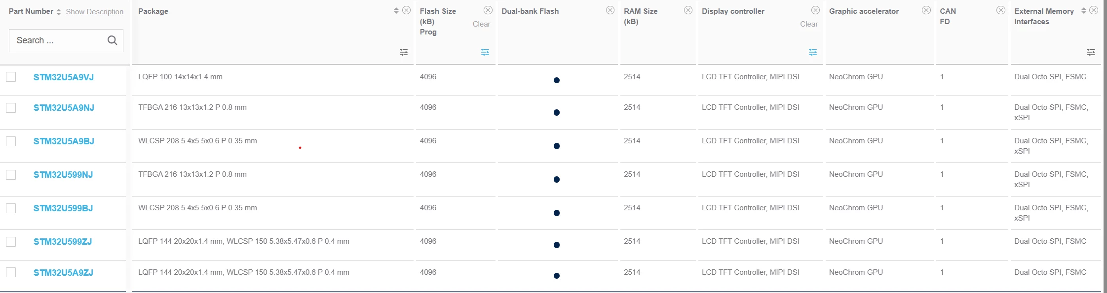

Please see attached screen shot of a product search. For example, the DSI-config does not come up in my STM32CubeMX (ver. 6.9.1) for the first one on the list STM32U5A9VJ.
It does, however, come up for one of the devices with higher pin counts.

Hello @Southbranch ,
The STM32CubeMX6.9.1 and  DS13543 are correct. The bug is in STM32 MCU product selector - STMicroelectronics web site.
The The DSI feature isn't available in STM32U5A9VJ MCU.
I reported internally.
Thank you for bringing this issue to our attention.
