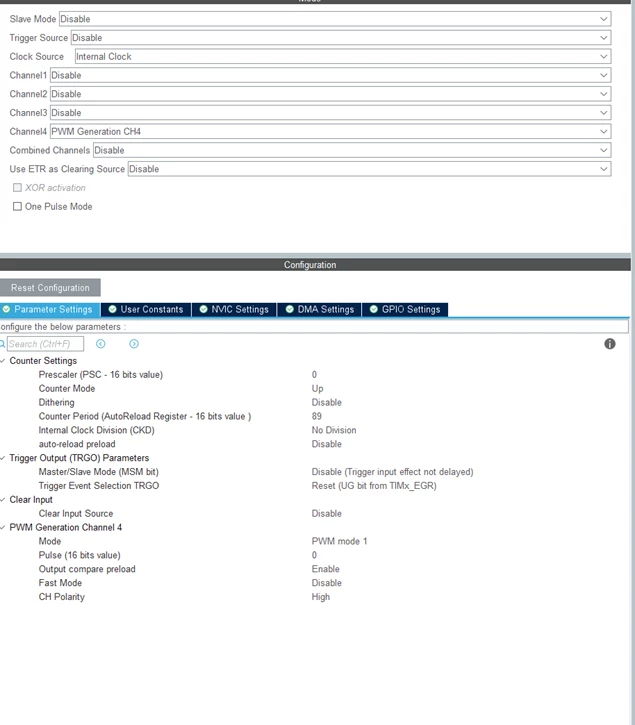

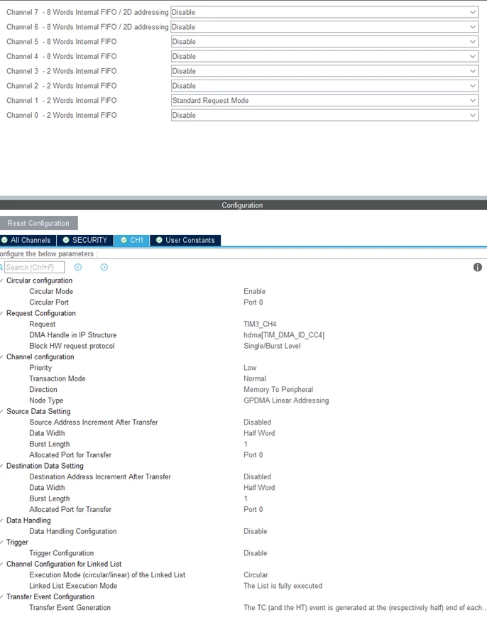

Hi! I am configuring DMA to generate a PWM signal to control addressable LEDs with an STM32563VGTx MCU.
My issue arises when generating the PWM signal using DMA. When calling the "HAL_TIM_PWM_Start_DMA" function, it executes without any errors, and the finished callback is triggered, indicating the completion of the data transmission. However, i am not able to see the data displayed on the logical analyzer.
I have verified the signal generated with a logic analyzer, and at all times, the signal remains at 0. I believe the error is not so much in the code but in the configuration of DMA and PWM.
Thanks for your help.
This is my GPDMA configuration:
This is my PWM configuration:

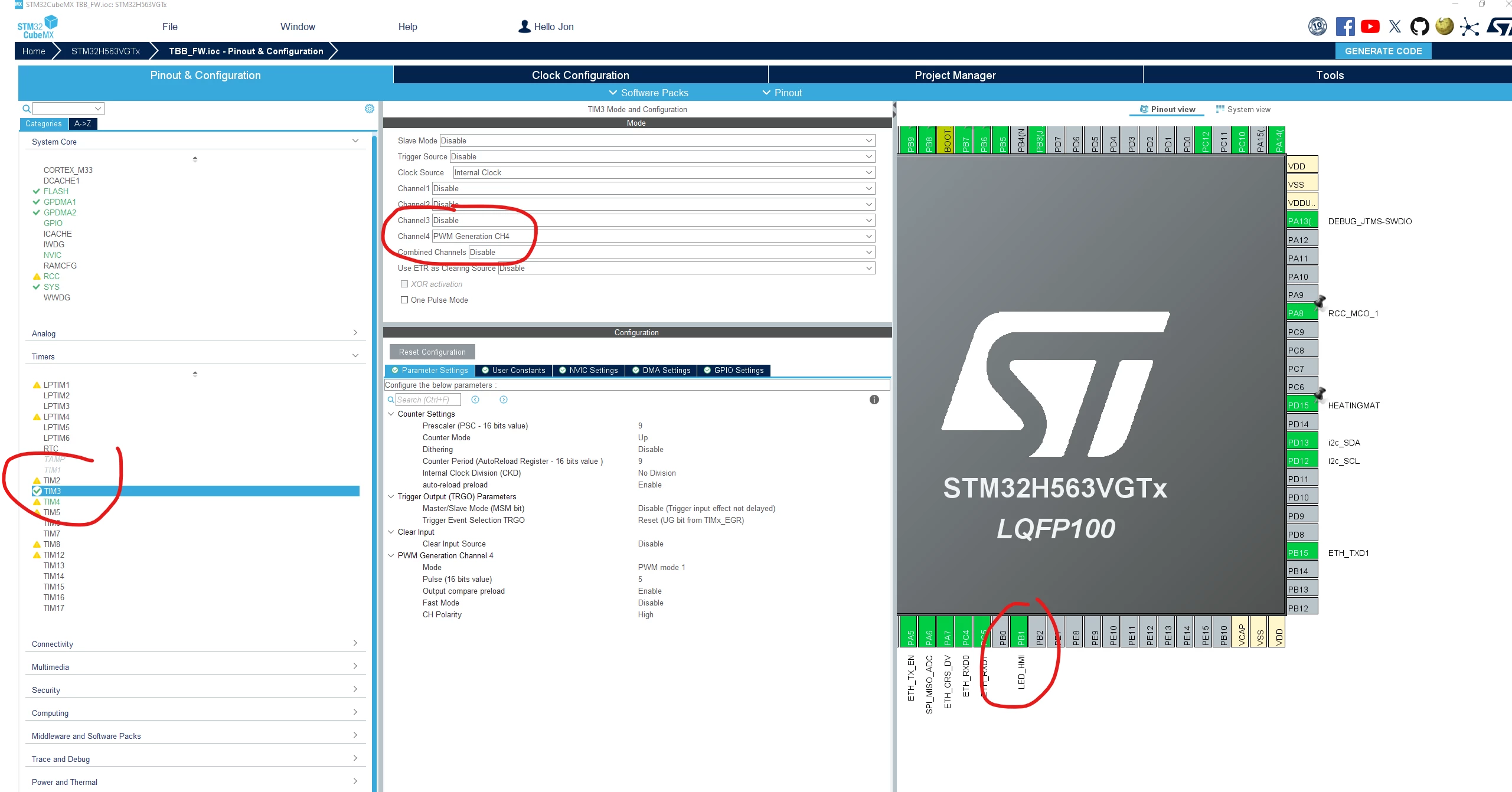

hello,
I have tried to test PWM on pin PB1 (TIM3 CHANNEL4) and PWM is not generated. With the same configuration, PWM works on pin PD15 (TIM4 CHANNEL4). The ST configuration allows me to set it up, but could it be that this pin does not support PWM?
With pin PD15, where I have been able to configure PWM successfully, DMA still does not work. What could be the cause of this?
ty,

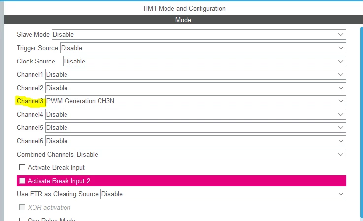

January 22, 2024
Hello @JonConesa
Try using TIM1_CH3N on PB1

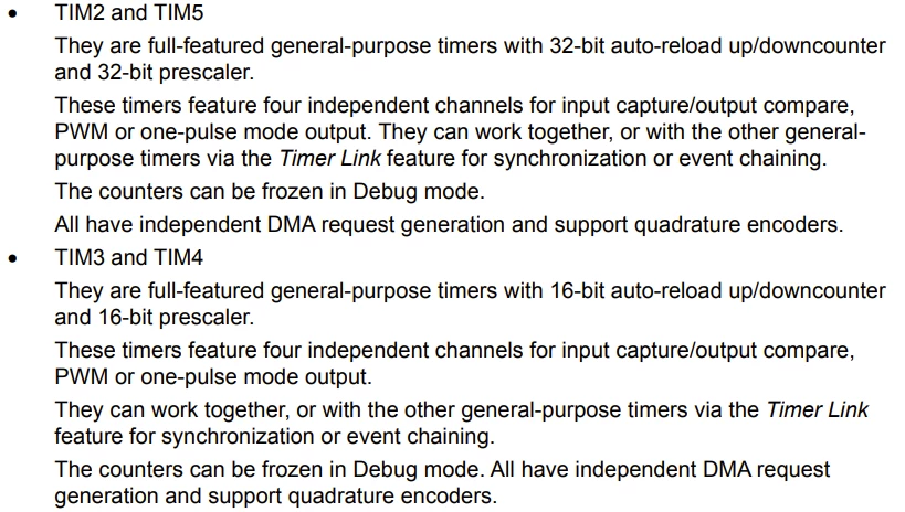

I have a custom board with the STM32F563VGTx MCU. That's why I chose Timer 3 CHANNEL4, as it turned out to be the most suitable option for routing. Furthermore, when testing Timer 5, it worked correctly in generating PWM through DMA. Is it possible that I can only generate DMA with Timers 2 and 5?
