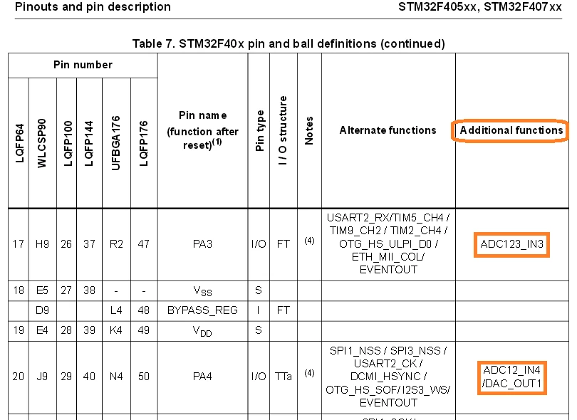

Posted on March 21, 2014 at 15:13
Hi guys,
I am a beginner and just start playing around with the board. I need some help on configuring 2 analog inputs for adc3. I already looked at the peripheral example. It seems like it is only configured for 1 pin. Also, I have a question regarding to the adc dma example. In the example, PC2 is configured as an analog input. How do you know that PC2 is connected to ADC3 channel12? If i have 2 analog inputs, do I just pick random 2 pins and hook it up 2 random channels? By the way, I am using stm32f4discovery. Please advice. Thank you.

    Posted on March 21, 2014 at 15:22
    No, you review the
    http://www.st.com/st-web-ui/static/active/en/resource/technical/document/datasheet/DM00037051.pdf
    for the part and review the pin and function designations.
    You'd review the
    http://www.st.com/st-web-ui/static/active/en/resource/technical/document/user_manual/DM00039084.pdf
    for the STM32F4-DISCO to understand what pins are free to use.

    wesleyklhk
    March 21, 2014
    Posted on March 21, 2014 at 15:28
    are you referring to the alternate function pins? but the example does not configure any pins as alternate function.
    wesleyklhk
    March 21, 2014
    Posted on March 21, 2014 at 15:33
    Could you tell me where in the manual that tells me the mapping from a GPIO pin to an adc channel? I am having a hard time finding it.

    Posted on March 21, 2014 at 15:40
    Analogue functions are treated slightly differently than Digital AF/GPIO ones
    void GPIO_Configuration(void)
    GPIO_InitTypeDef GPIO_InitStructure;
    RCC_AHB1PeriphClockCmd(RCC_AHB1Periph_GPIOA, ENABLE);
    /* Configure ADC1 Channel3 & 5 pins as analog input ******************************/
    GPIO_InitStructure.GPIO_Pin = GPIO_Pin_3 | GPIO_Pin_5;
    GPIO_InitStructure.GPIO_Mode = GPIO_Mode_AN;
    GPIO_InitStructure.GPIO_PuPd = GPIO_PuPd_NOPULL;
    GPIO_Init(GPIOA, &GPIO_InitStructure);
    wesleyklhk
    March 21, 2014
    Posted on March 21, 2014 at 15:41
    thank you so much
