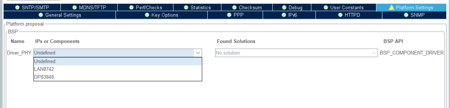

One more question, I see some config in cubeMx as below:
My board also has a DM9161CEP with RMII interface, so I can config the ETH and LWIP.
But here must choose DP83848 or LAN8742, do your know what's the influence about this option?
