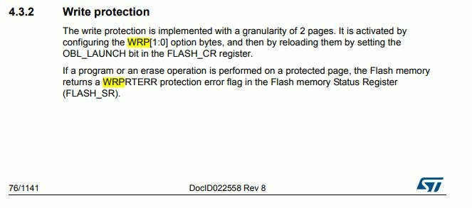

How to code to implement WRP (write protection)?
Hello, Is there any tip or reference code to implement WRP? I need to prevent changing original codes and adding any other codes from malicious third parties.
I use stm32f303k8 and CubeIDE.
I appreciate any help you can provide.
Imen.DBest answer
September 19, 2022
Hello @伸弥 北郷​ ,
You should be able to change the settings in STM32CubeProgrammer.
Please check RM0316, "4.3.2 Write protection" section for more details.

Thanks, Imen.
I will try to use STM32CubeProgrammer.
