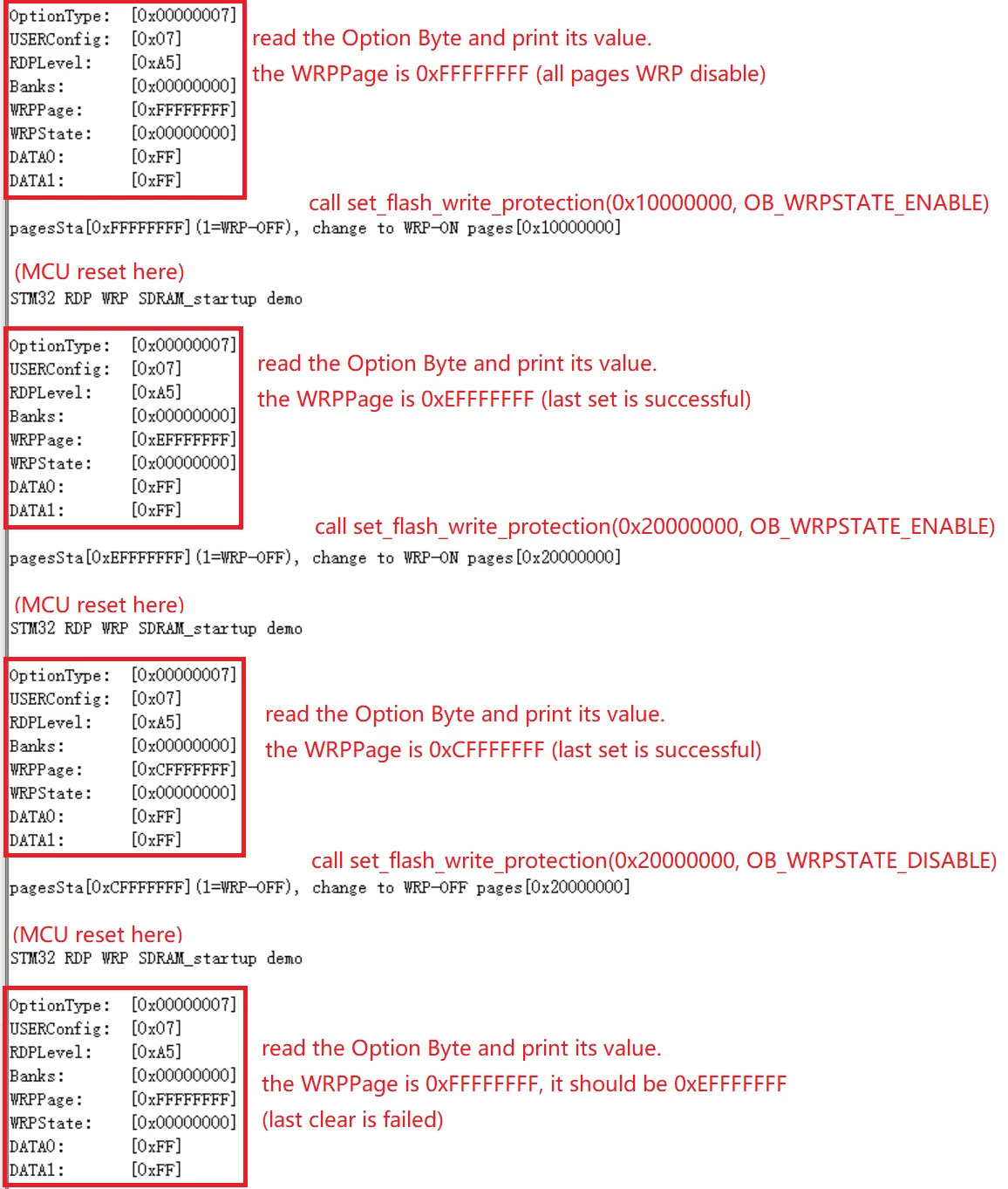

Junde
JundeAuthor
Senior III
November 19, 2024
Hi @Amel NASRI, thanks for your reply!
I already referenced this example before I posted this question. Anyway, I reread it and wrote the test demo as follows:
 *	@brief	set Flash pages WRP state
 * 	@param	pages	@ref FLASHEx_OB_Write_Protection in stm32f1xx_hal_flash_ex.h
 *	@param	wrpSta	@ref FLASHEx_OB_WRP_State in stm32f1xx_hal_flash_ex.h
 *	@note	each bit in WRPPage means one page: 1 is mean this page's WRP is disable, and 0 is mean enable
 *	@note	can NOT clear the WRP of part pages, only clear ALL!
void set_flash_write_protection(uint32_t pages, uint32_t wrpSta)
	HAL_StatusTypeDef hal_sta = HAL_OK;
	FLASH_OBProgramInitTypeDef OBInit = {0};
	HAL_FLASHEx_OBGetConfig(&OBInit);
	LOG_DBG("pagesSta[0x%08X](1=WRP-OFF), change to WRP-%s pages[0x%08X]\n", OBInit.WRPPage, wrpSta?"ON":"OFF", pages);
	if(((~OBInit.WRPPage & pages) != pages) && (wrpSta == OB_WRPSTATE_ENABLE)) {
		HAL_FLASH_Unlock();
		HAL_FLASH_OB_Unlock();
		OBInit.OptionType = OPTIONBYTE_WRP;
		OBInit.WRPState = OB_WRPSTATE_ENABLE;
		OBInit.WRPPage = pages;
		hal_sta = HAL_FLASHEx_OBProgram(&OBInit);
		if(hal_sta == HAL_OK) {
			HAL_FLASH_OB_Launch();
		} else {
			LOG_ERR("set Flash WRP err[%d]\n", hal_sta);
	} else if(((OBInit.WRPPage & pages) != pages) && (wrpSta == OB_WRPSTATE_DISABLE)) {
		HAL_FLASH_Unlock();
		OBInit.WRPState = OB_WRPSTATE_DISABLE;
		} else {
			LOG_ERR("clear Flash WRP err[%d]\n", hal_sta);
The LOG as below:
My code is almost the same as the example, but why can't it work?
Please help me, thank you.
