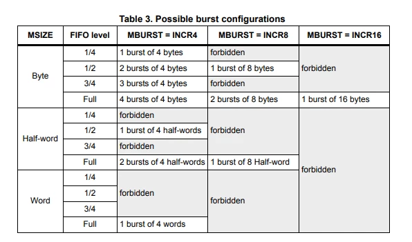

I'm checking the default configuration of an ethernet communication project based on STM32F2 microcontroller (RM0033 stm32f207 reference manual). Where the comments I'm gone to do, they could be find on section 28.6.2 (page 881, etc). I think it doesn't mind but my ethernet application is using HAL driver layer, LwIP and no RTOS.

So now, and having this other found DMA information in mind (AN4031 dma controller AN - 12 and 13 pages):
My doubts are:
  1. When talking about INCx, where should this INCx be put? What is an INCx? Is it a burst length?
  2. What is the legal max value of burst that can be programmed and how is it chosen?
  3. If my project is using a default configuration that has RDP options for programing the burst size and its value is set to 32: What does exactly this 32 mean regarding to the burst size? 32 bursts of what? Is it a burst of 32 data unit? beats of 32 bursts? bursts of 32 beats? burst of 32 bytes? Burst of 32 bits?
  4. What about the max data length to be read 16 byte-sized? If this field is 32:
  • 1 byte --> 32x1 byte = 32 bytes > 16 bytes,
  • 2 bytes --> if 32x2 bytes > 16 bytes and
  • 4 bytes --> 32x4 bytes = 128 bytes > 16 bytes.
  1. What about PBL/RDP value (32) and the FIFO size (2 kB)? What a relationship between these two values is?
Please if some one could briefly making a comprehensive and better explanation I will be very grateful. Should I write a PBL value less than "32"?
