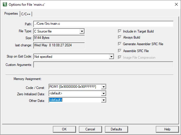

how to check if program is indeet loaded to exteral flash and runs from there?
  • May 8, 2024
  • 11 replies
  • 4252 views

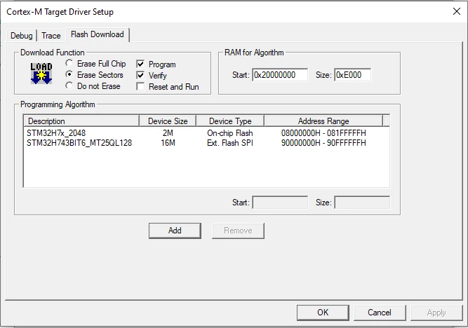

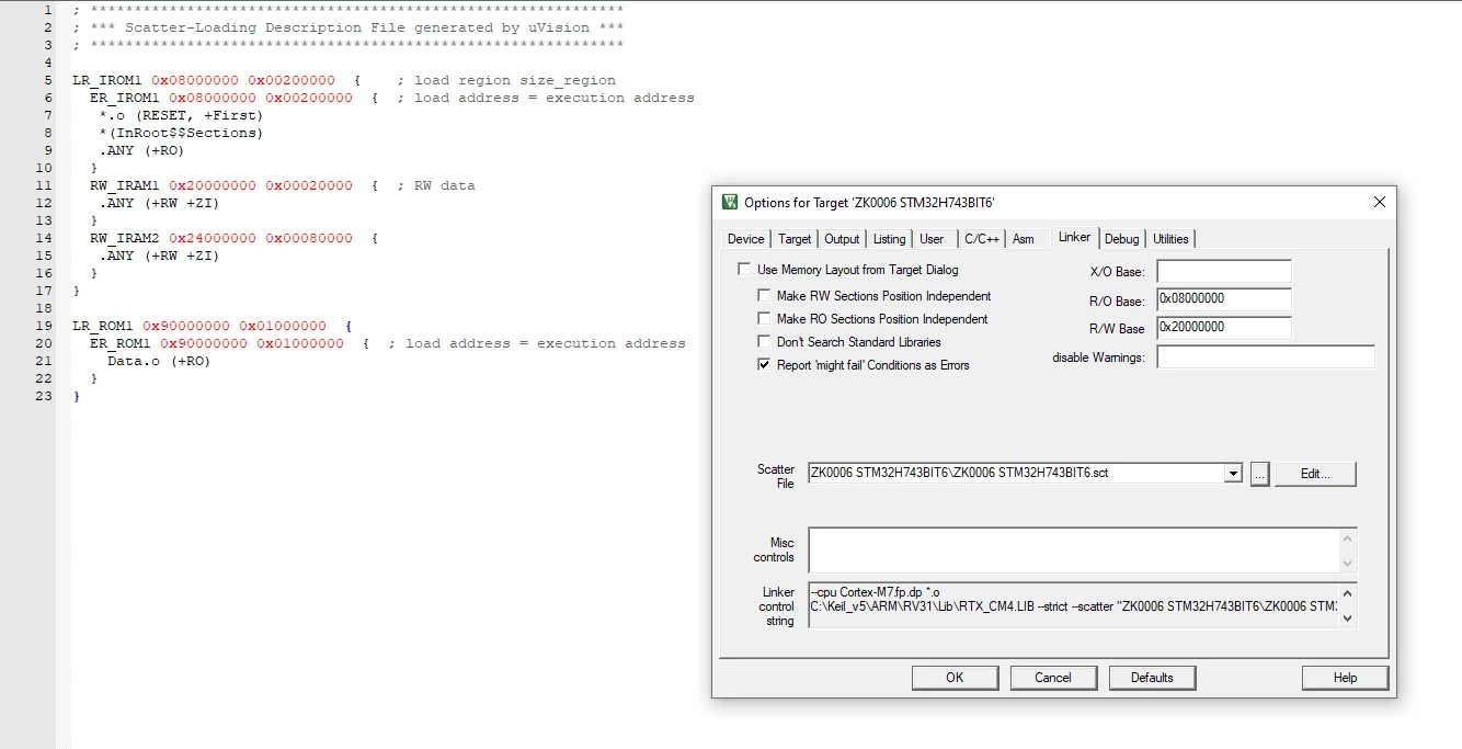

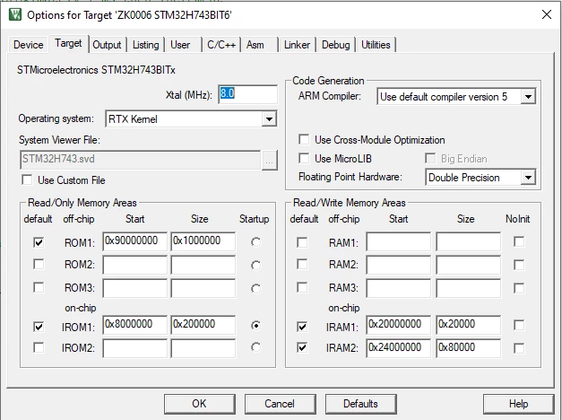

everything is working, downloads and runs, I am still not sure it the external QSPI works.
I can write and read from QSPI, checked but I am not sure if it works as external flash to load the code and run from it.
I chose to put main.c in external flash (is this the way you do ?)
but the bar in Keil only and always shows that it is loading to internal flash

MNapi
MNapiAuthor
Senior II
May 8, 2024
the main.c is less than 10K compared to the whole thing over 1M
the board is running I cannot confirm if from internal flash or external, I might still be missing something
