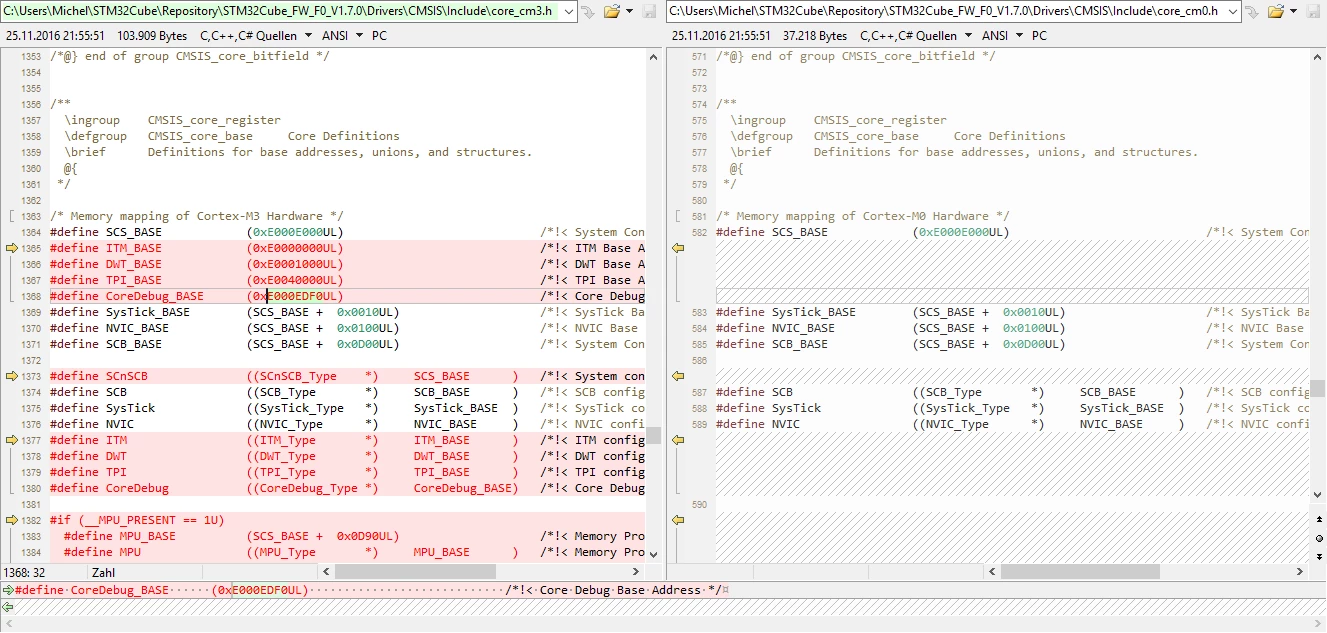

    Unfortunately the target processor is a STM32F072 (Cortex M0) and the detection is not working.
    The ARM documentation for Cortex M0 lists the DHCSR register:
    http://infocenter.arm.com/help/index.jsp?topic=/com.arm.doc.ddi0337e/CEGCJAHJ.html
    but there is no detailed description about the bit definitions or the address of the register ...
    Also the CMSIS register header file shows a lack of the CoreDebug_BASE register
    Is this feature simply not available for a M0 device ???
    They dropped a lot of functionality out, which I've always felt is a step backward, which is why I don't have much time for the M0.
    Look at the DBGMCU registers, and the clocks in the AHB/APB enabled at ResetHandler... because the debugger has likely tweaked things to suit its needs.
