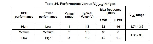

How to change VOS bits in 32L0xx
Posted on January 25, 2017 at 08:19
According to reference manual RM0377 (page 138 6.1.5 Dynamic voltage scaling configuration)  programming voltage regulator is very easy. Unfortunately I'm not able to do this on two Nucleo demo boards with STM32L031 and STM32L053 MCUs. After writing a new value to VOS bits in PWR_CR register, I read always the same value 1.5V (range 2). Is there any other condition, except power supply, that has influence on this? Please help me to solw this problem.

waclawek.janBest answer
Jan 31, 2017 9:53 PM UTC
Posted on January 31, 2017 at 21:53
To be able to write to PWR registers, you have first to enable PWR's clock by setting RCC_APB1ENR.PWREN.
With the ADC problem, please start a new thread.

An embedded linear voltage regulator supplies all the digital circuitries except for the Standby circuitry. The regulator output voltage (VCORE) can be programmed by software to three different ranges:
  • Range 1 (VDD range limited to 1.71-3.6 V), with the CPU running at up to 32 MHz
  • Range 2 (full VDD range), with a maximum CPU frequency of 16 MHz
  • Range 3 (full VDD range), with a maximum CPU frequency limited to 4.2 MHz
