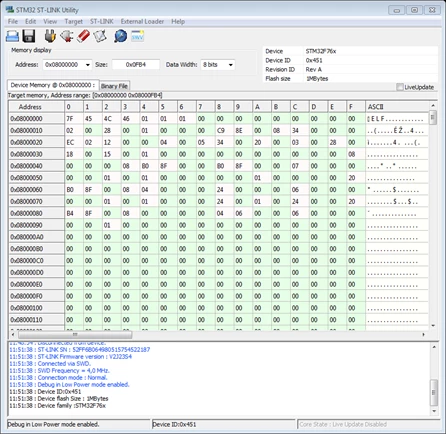

How to change the program start address to the second section in an STM32F765VGT
Posted on July 03, 2017 at 13:51
I need using the first 32Kb flash section in order to store data in an STM32F765VGT (1M of flash). How can I change the program start address to the second section. I�ve achieved to reallocate the program code in the second section by means of the linker script. But when I explore the first section with the stlink utility, in the first section, there is a piece of code instead of being empty. Furthermore if I erase this section the program stops working.

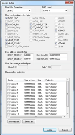

The default values of the option bytes are:
With the default values in the option byte the program dosen?t work.

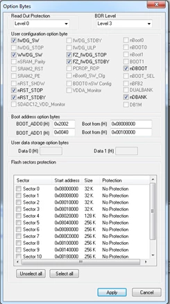

I tried change it for pointing to the 0x08008000 (flash second sector star address):
But with these values still not working.
Although my program should be in the 0x08008000 address if I read the 0x08000000 there are some code:

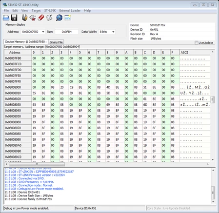

If I read the 0x08008000 seems that the program is stored in this area.
I don?t understand why the first section (0x08000000) isn?t emty.

bbee
Senior
Jul 4, 2017 1:33 PM UTC
Posted on July 04, 2017 at 13:33
I think
Turvey.Clive.002
‌ means AN4826 and AN26
Beside that it looks like you have flashed the elf file right to the default start address (see the ELF pattern at address 0x08000000). You should create a hex or binary file out of the elf and flash this instead of the elf file.
