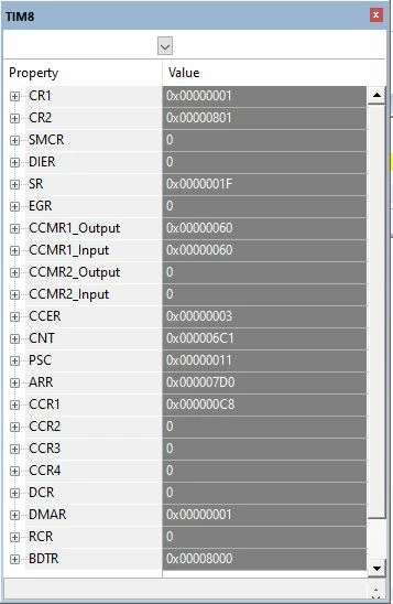

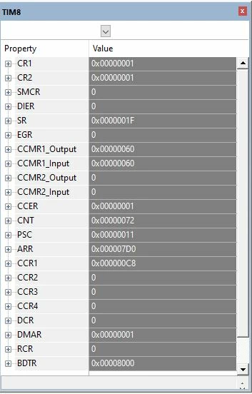

MaedeMpr
MaedeMprAuthor
May 10, 2020 10:33 AM UTC
CC1P in CCER has changed that is normal but OIS2 in CR2 has changed too.
waclawek.jan
May 10, 2020 12:20 PM UTC
OK so now if you perform the same change by directly writing to registers, you will see the waveform changing in the same way too.
To try it, you don't need to write any code, simply change it directly in the debugger.
