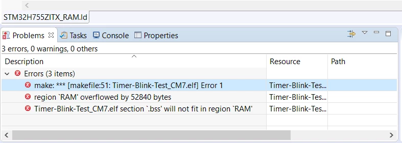

When I want to assign a value into this variable, the compiler shows the RAM overflow error. I read some application notes of ST and some block of memories have different address but I don't know how to use the in linker script.

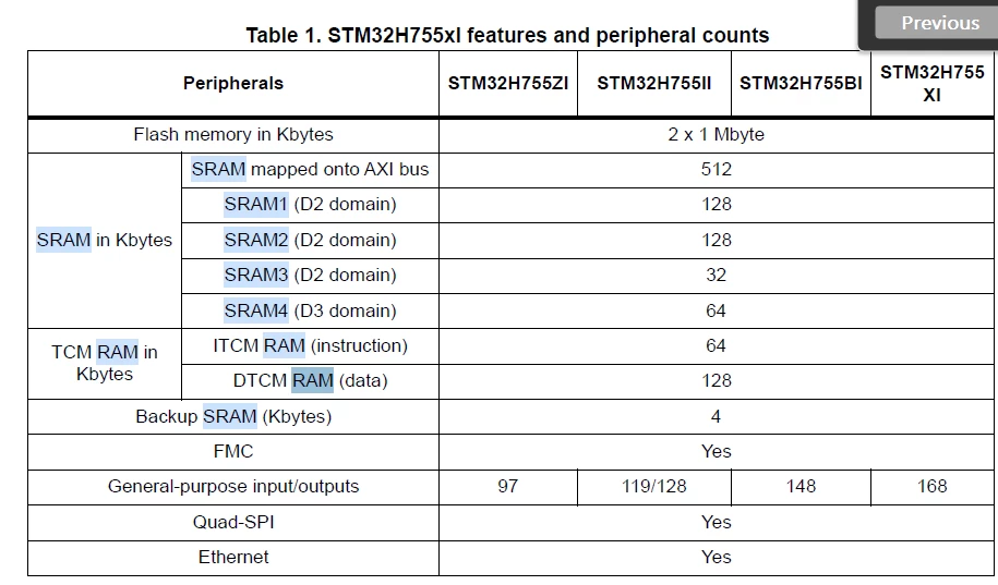

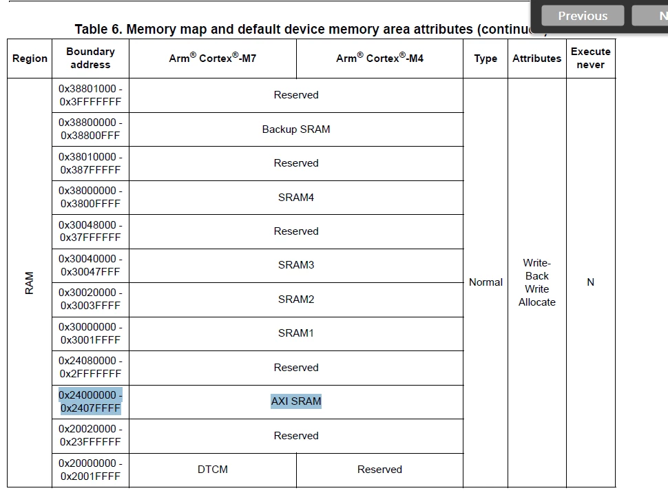

another thing I am considering is that the RAM blocks are as follows:0693W000006HdaLQAS.png
based on Linker script file I mentioned before, a 256KB block is only used . that is the reason of RAM overflow ,I think... .
2) How Can I use a bigger block? for example the block the name of which is SRAM mapped onto AXI bus 512 in the table below?
Despite the searches I did I could not understand how to change the linker-script files. Is there anybody who has time to help me regarding the mentioned two questions??
I think the more logical choice is to just select the bigger RAM In D1 domain which is also provided to M7 Core I am using ....
I tried changing the address space of the ram in the .ld file . at first, it was from /* : ORIGIN = 0x24000000, LENGTH = 256K */ to /* : ORIGIN = 0x24040000, LENGTH = 256K */.
then I changed it from 0x24000000, LENGTH = 512K to : ORIGIN = 0x2407FFFF, LENGTH = 512K according to memory-map file in the user manuals but after biulding the project I still get the ram overflow messege...... Please Help :)))

    Thanks Tesla DeLorean, I still get the same RAM overflow errors. If you have time can you please explain what changes did you do in the linker script?

    The data still has to fit.
    Not clear why the entire code/data needs to be in RAM. You might want to look at alternate ways of loading the RAM, ones where it doesn't need to copy initialized statics from one section to another, basically halving the available resources.
    Perhaps you can look at the .MAP file as see where all the resources are being sucked up? You can make the MEMORYs unduly large so the linker can get closure, and then walk the file.
