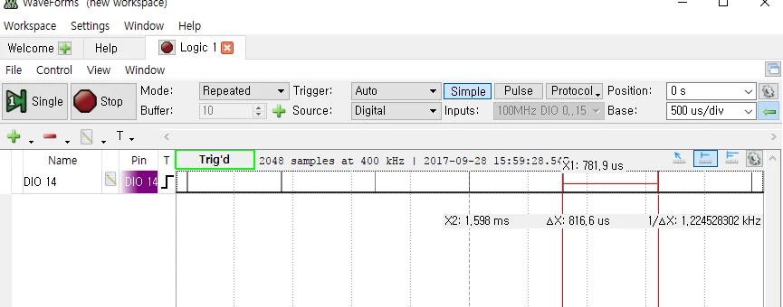

When I set with the following setting, I've got the below waveform.
TIM_TimeBaseStructure.TIM_Period = 71;
TIM_TimeBaseStructure.TIM_Prescaler = 999;
TIM_TimeBaseStructure.TIM_ClockDivision = 0;
TIM_TimeBaseStructure.TIM_CounterMode = TIM_CounterMode_Up;
TIM_TimeBaseInit(TIM2, &TIM_TimeBaseStructure);
/* TIM Interrupts enable */
TIM_ITConfig(TIM2, TIM_IT_Update, ENABLE);
/* TIM2 enable counter */

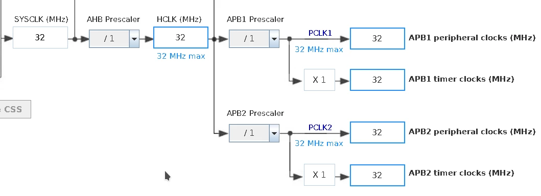

    Is TIM_CLOCK specified in the datasheet, or is something we can pick from the Configuration Clock diagram in CubeMX (the diagram is for an L152RE)?
    Won't be better to have some combobox controls in the ''Parameter Configuration'' window of the Timer, related to the ''things'' already set in the Configuration Clock diagram and related to some named variables in LL/HAL drivers? I'm thinking in the relation with the other comment I have here. And we must see the resulted tick period displayed, to see if we managed to do it right.
    Tesla DeLorean
    Guru
    September 29, 2017
    Posted on September 29, 2017 at 01:10
    It would be under the Clock Tree Diagram, the source for the specific TIM would depend on the APB the TIM is attached, nominally 2x APB

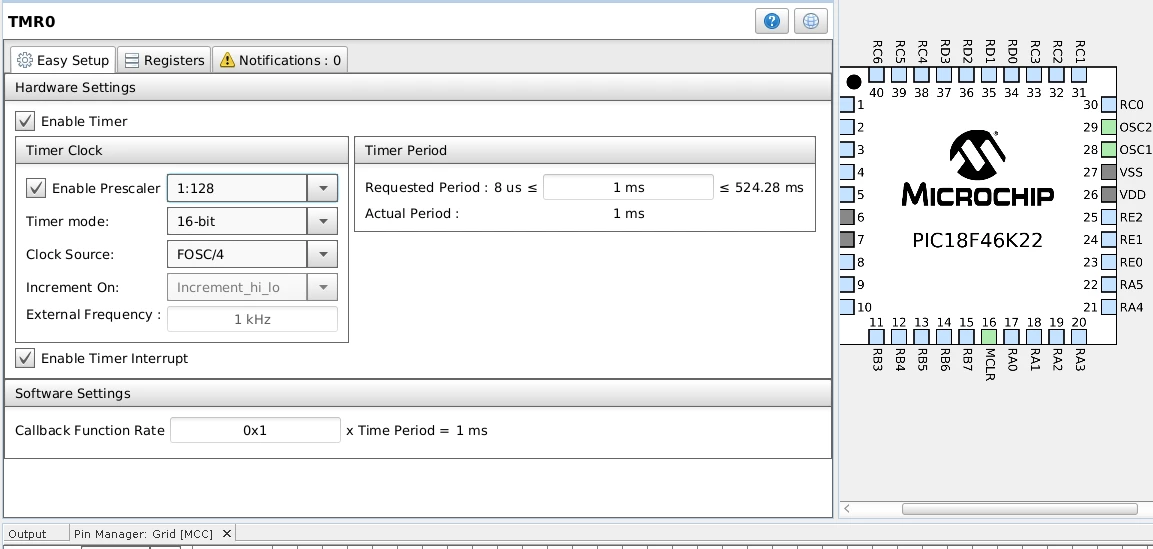

    Microchip has something very nice regarding the visual code generator, you can specify the period in milliseconds or microseconds and it shows all the changes, results and generate the right code for you. This should be another improvement/proposal for CubeMX.
